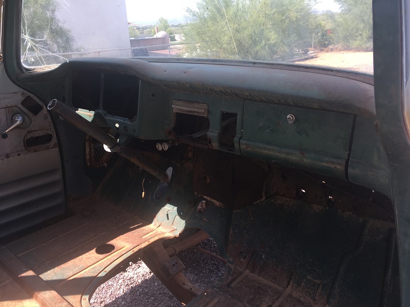

Came across a 59 Impala dash and though it would look amazing. The factory GMC dash is kind of plain.

Cut the old dash out.

Fitting the 59. Had to cut about 4" out of the middle to get everything sitting correct. Added a spot for the A/C controls and stereo in the middle. Started on the floor cover and cut out the 6 cylinder firewall hump.
