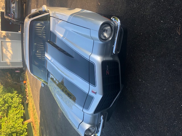

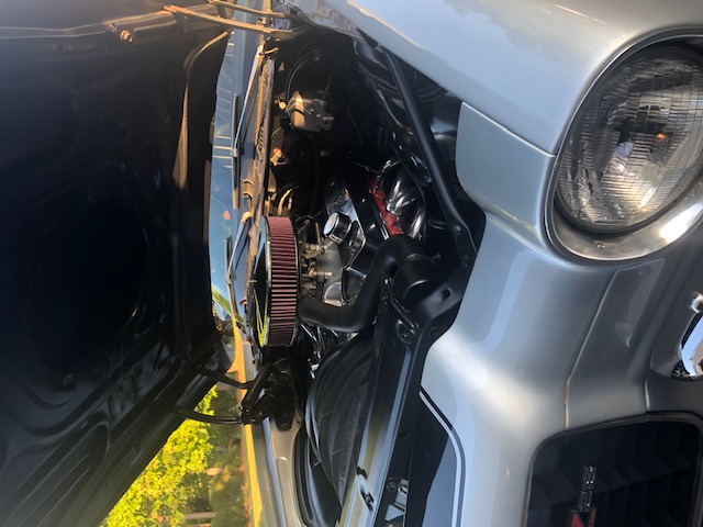

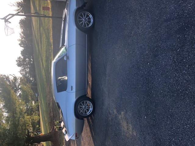

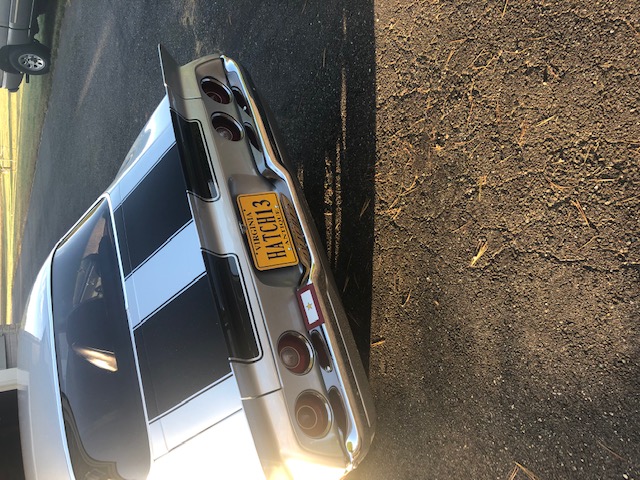

Not any progress but will turn on it once the engine and drive train are sold. Not sure why the pictures are not sitting correctly. Sorry
