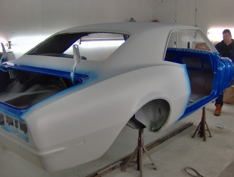

I am starting to build up my 68 Camaro. but what is wise:
- first build up the total car and than let it paint
or
- paint it first and than the build up?
I see Barry White on Discovery Channel (Wracks to Riches)do the paint first and than do all the other bodywork and buildup.
What are the pro's and con's.

Mechanical, Suspension, etc First!! Paint last. You want a rough car to do all your initial mock up on, or at least I do.
Now if you are just adding on some bolt on stuff, wheels, springs, suspension, etc. And require no cutting or fitting. Then paint it first.

Why don't you paint the underside first, then bolt on the suspension that you already have, then install the engine/tranny, then mock up the complete car, then pull the front sheet metal/doors off and send it to paint. That way when you get it back from paint, you'll only have to do wiring, interior and trim?
I'm not the expert, but at least that way you could get it off the dolly and get the car into a one piece roller.

In my opinion, its best to paint after everything is mocked up, You don't want any scratches,dents, or dings on the car before you even get to drive it.

I'm in between-paint underside, get it rolling- paint rest, install eng, trans etc, bada-bing-bada-boom...your done. Any way you do it, it's gonna be a killer car.-Chris

always mock up the entire car first.........
painting first we be like eating desert before cooking the meal.
not a good idea
1.strip
2.modify/chop/cut/etc
3.assemble
4.body work
5.reassemble
6 paint
7.assemble
those are pretty much the steps we use....expect the part where you scratch it putting it togther and have to repaint something...lol

We build / fabricate and assemble / disassemble a car no less than 4 times before paint is ever considered on any part.
You should never have to drill a single hole after paint.
