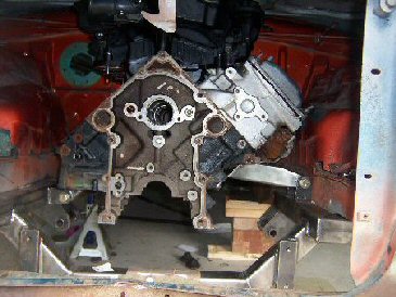

Haven't posted in awhile. Got the alterktion frame and mounts on and wanted to see how the hemi would fit in. I didn't think my 64 darts hood was gonna clear the truck hemis throttlebody, but it did by an inch. This was the first time ive ever had the hood on, when i bought my car 2 years ago it was off. Almost looks like a car again.
I have to modify the passengerside fenderwell so as to make getting the valve cover off on that side possible without bringing up the motor. Two of the valve cover bolts touch here.

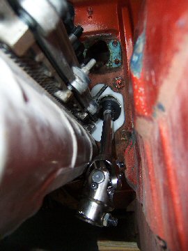

alternator and a/c compressor clear, and if ya use the AlterKtion, you wont need a remote oil filter or a center sump pan, the truck hemis rear sump clears very nicely. I put my Flaming River stearing column in to see how it would fit. It doesnt touch the rear corner of the head, the plate i got from Bill at RMS moves the column over abit so i didnt have any problems. The U-joint clears, but ill have to trim up my heat shield a touch.

How much did you have to move the column?

Maybe a half inch, maybe a touch more. Looking at old shots of my enginebay, it looks like the old column was a touch more center. Its not noticable inside the car at all, which was one of my fears.
