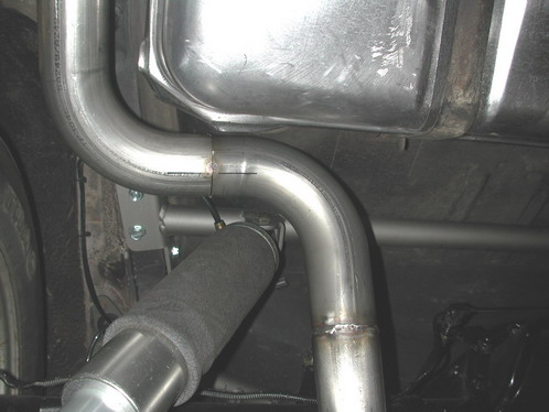

Frank I have been eyeing this system for a while. Can you tell me your honest opinion, would my tailpipes have to be re-built in order to clear the G-bar setup? Darren posted a pic a while back that looked like the tailpipes had to be moved. Reason I ask is my new exhaust cost quite a bit of $$$ and I'd hate to have to rebuild it. But I really want a setup with ride height adjustability.

Ryan, it would be hard to say if a given exhaust will fit or not as no 2 systems are indentical. There does seem to be a bit more room with the smaller diameter Coil overs then with the Shockwaves. But even with Shockwaves exhaust can be snaked through. I would imagine that even if your tailpipes did require some modifications, it would be pretty simple stuff.
Mike, let me see what I can find for pictures.

Stainless Works was working on a tail pipe specific for this suspension. Here are some pics of how we routed the exhaust on our car.
