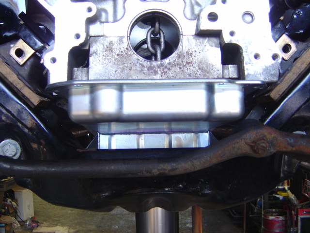

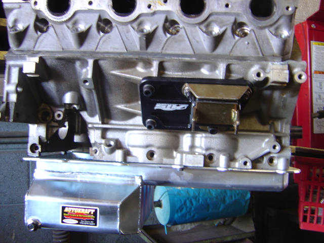

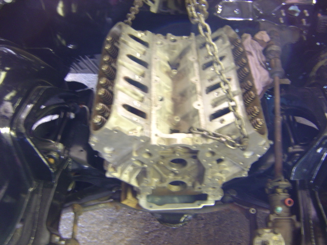

I've got the engine laid in looks like there are some clearence issues with the centerlink and the pan. I think I'll just fab some slightly higher frame brackets to clear. The 4l80 looks like it will fit with just some slight clearencing above the tailhousing where it bolts to the case

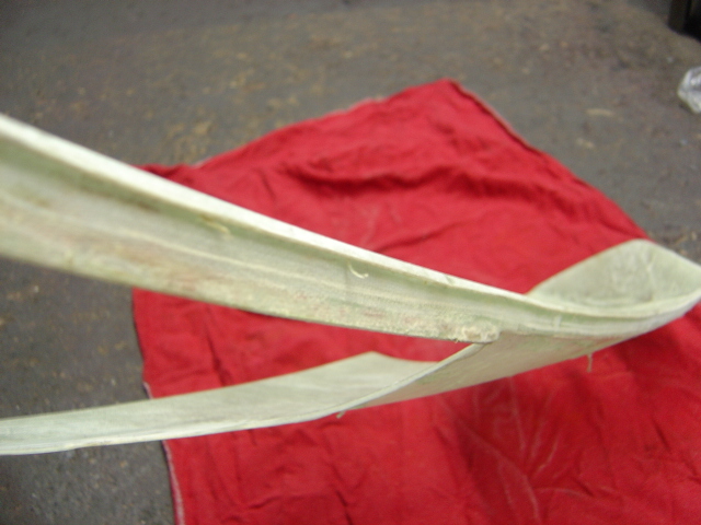

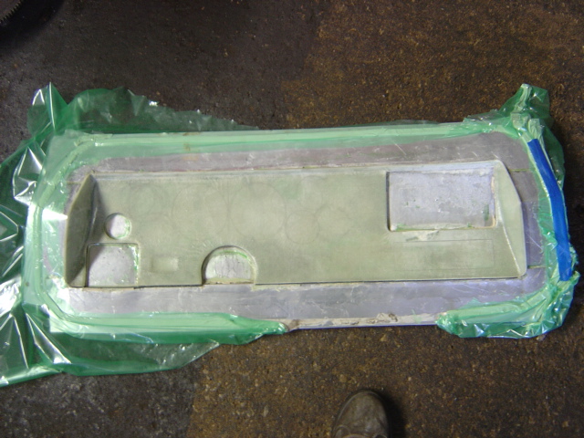

A little progress. I'm taking a shot at my own door panels.
Foam model
Im going to use mdf to make the panel so I can make a mold. the finished piece will be fiberglass.
