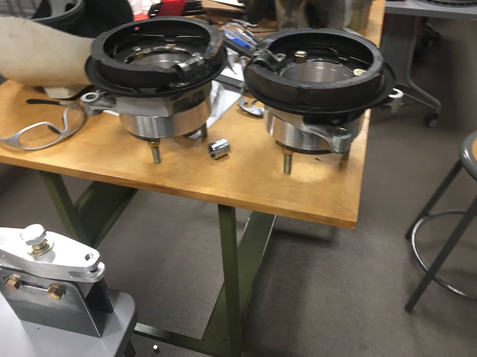

Here you can start to see that the spacers and the spindle and the steel bracket are coming together to make a complete braking system. At this point I have made a huge miscalculation, but I don’t know it yet?
I also bolted the aluminum spacer to the original spindle to bore it out and then turned it again to face it smooth and parallel.
Certain things require small clearancing, like the E-brake adjuster and some other stuff.
I have also placed the suspension brackets on the rear end so I don’t forget them later. I actually don’t forget them later too. That’s kind of nice isn’t it?
