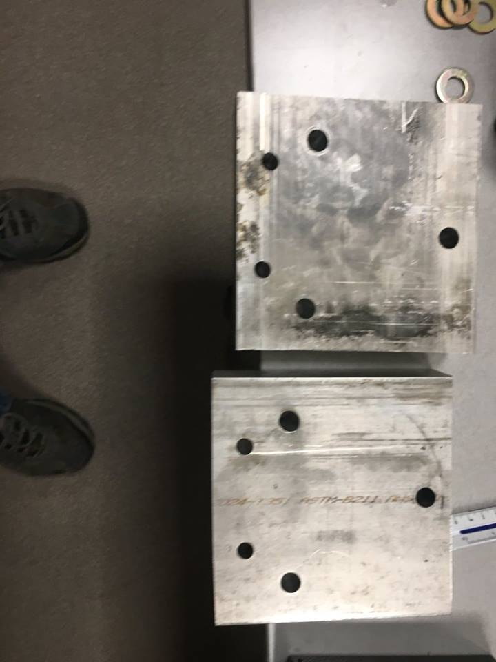

More going on here that it appears. Now I could have borrowed my buddy David’s belt sander and effed it up royally or I could go on KIJIJI and see if anyone has one for sale. Yes a quick check found on for 60 bucks and it had a few belts with it. I learned years ago from watching a sprint car builder named Jerry Frantzen that sanding aluminum looks good and gets rid of weight. I actually raced one of his sprint cars for a few years when I was a hero in the division. Well at least as far as drinking beer and telling stories makes you a hero.
Those 4 drill bits and that tap was the best part of $200. If you look at my parts and my drawings you will also see what I said earlier about sometimes the part only uses the drawing as a suggestion. Also I went with a thicker piece for the watts rocker and switched to a double shear design to capture the ½ inch rod ends.
If anyone is wondering about the ¾ rod coupling bolted to the rocker, I may tell you later and I may not. I mean honestly I actually drew it out for you, sorta?
https://lateral-g.net/forums/attachm...1&d=1616018080

Here you can see how I am reducing the spindles to their simplest form to use as a bracket for the floater.
I also got into the CAD work for my watts link brackets for the rear end. (Cardboard aided design)
A lot of this stuff is my first real attempts at using a lathe accurately.
I also had my buddy Doug do some more plasma work for me. Then the boring job of sanding it all down had to be done.
https://lateral-g.net/forums/attachm...1&d=1616344896

Those brackets from the other day are deburred and sanded smooth. Brainless but tedious work. The bars that have all the holes in them are just suspension stiffeners and are for, well suspension stiffening! Don’t exactly know why I had to say more there HMMM?
You can also see that I have machined the watts rocker so it works in double shear. I used that ¾ rod coupling that I mentioned before as a mandrel to chuck it all in the lathe. Oh by the way it’s actually a 7/8ths rod coupling and I trusted my memory again when I really shouldn’t have.
https://lateral-g.net/forums/attachm...1&d=1616717958
