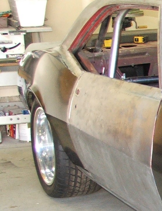

Trey, here's a pic of mine....man this goes back years and years! It's a 315 on a 17x10. Not the best angle, sorry!
Tony
