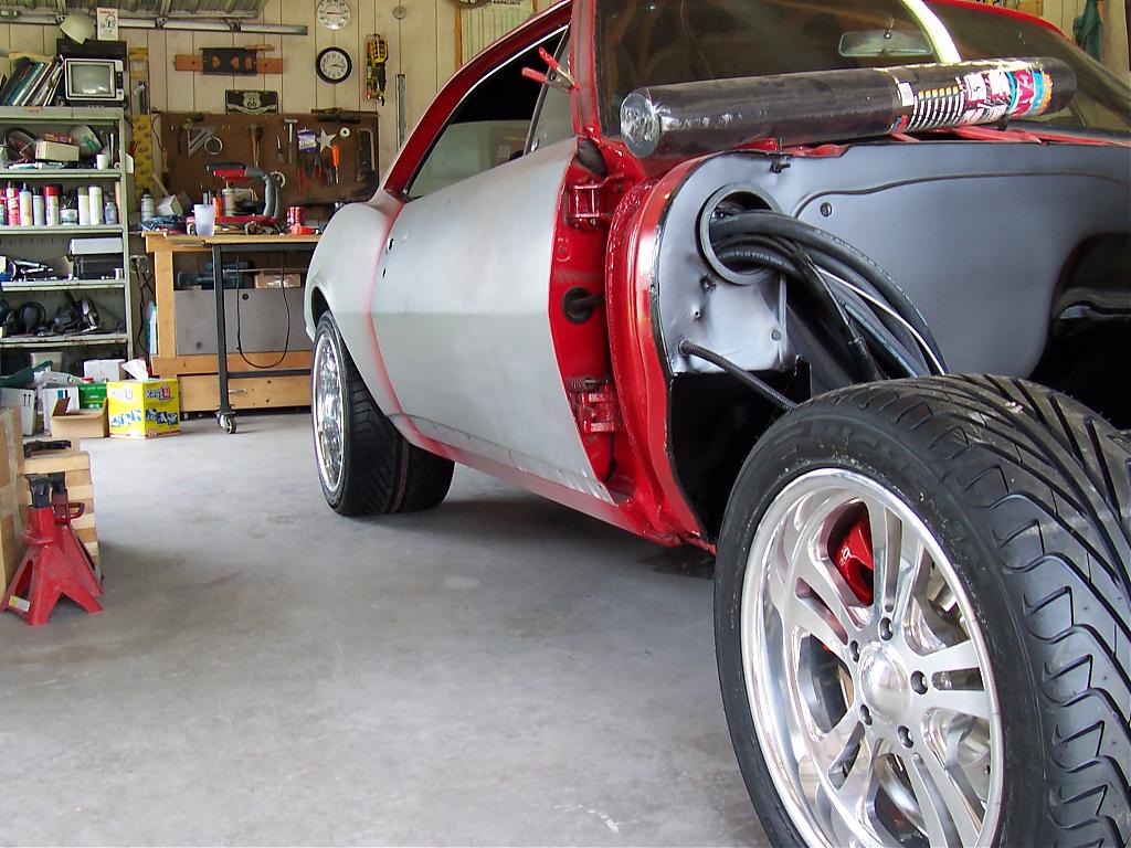

I have a 68 Camaro and just installed DSE tubs, quad and subframe connectors, but the 335 G force look like they will fit with the correct backspacing. Is there a thread out here that explains this?

We do 335s on 67 / 68s in our shop al the time, look at MotiV8r. But we know how to put the tubs in deep. Yours are installed relaxed. You need 14.5" to 14.75" to clear 335s on 12s. As Chris mentioned, 325s on a 11" rim are a nice fit but there are no 325 / 18s.

Frank said in this thread that if you put the tubs in deep, 335 will fit. What needs to be added and what backspacing?

Thanks Ken. I plan on using a dse front subframe too, but may wait and run the factory subframe. But can we get Baer brakes on the factory subframe and then change them to fit the DSE frame? I have the ford 9 from DSE with the Baer 6P brakes on the rear. I am just trying to get the tubs finished so we can get the wheels. I have purcahsed the 335s to see about fit, but it is tight. We have not finished welding the tubs yet, we also have to put the new rearend under the car and weld the final fitment.

I have 14.625" with the DSE tubs in place. So looks l ike there is r oom for the 335.
