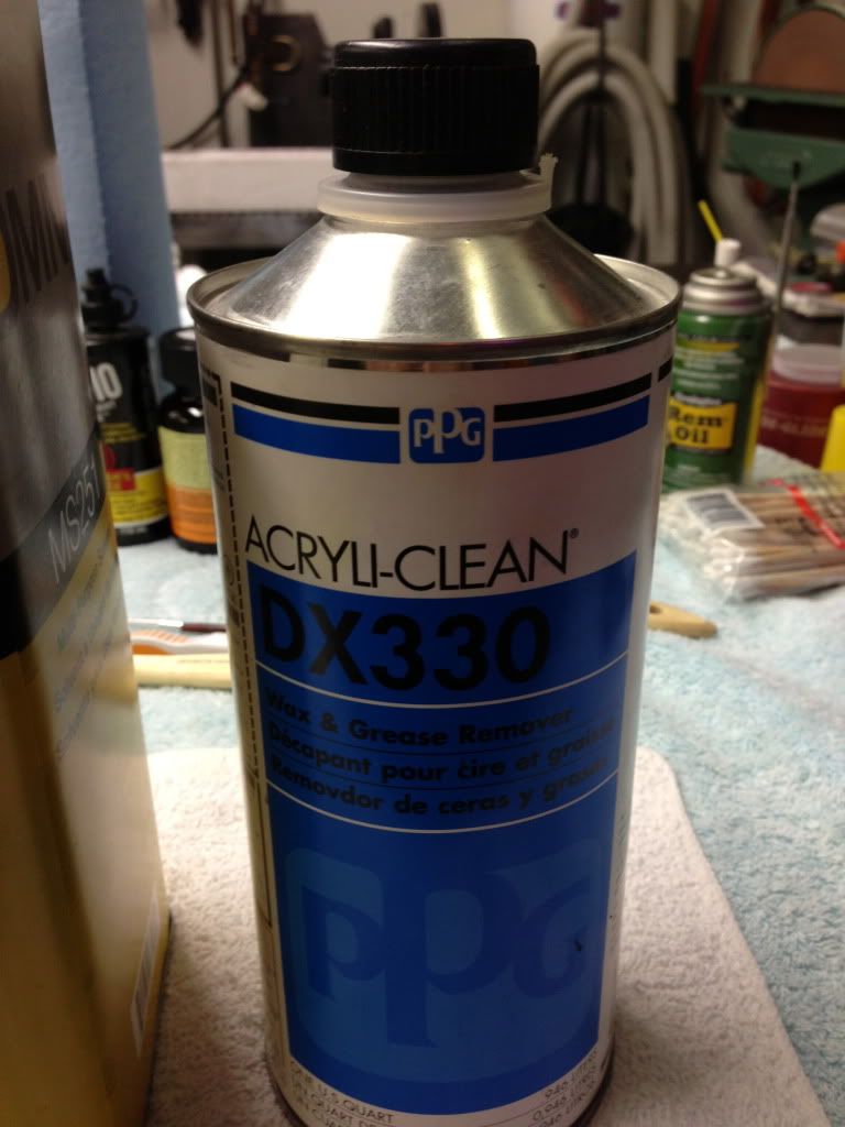

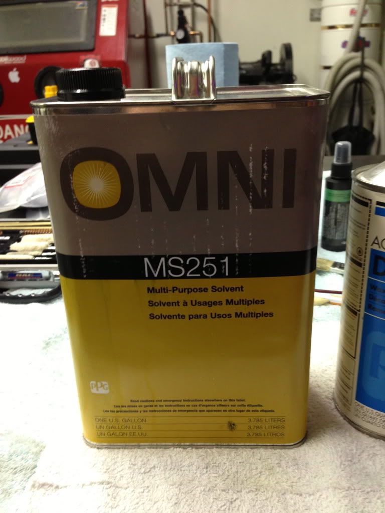

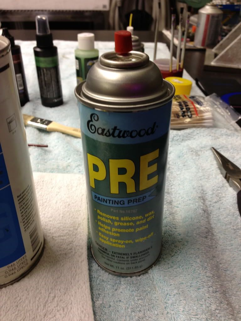

Okay -- I want you to know that I went down to the shed in my pajamas and slippers - in the POURING RAIN to get you some info on the stuff I keep around the shed for PRE sanding prep! Use whatever. Note the OMNI IS VERY STRONG STUFF.... the PPG Acryli-Clean and the Eastwood Pre can be used on almost ANY paint.
Thank you buddy, hopefully one of the local supply houses has OMNI MS251
The Eastwood stuff is right up my alley considering it's rattle-can.
