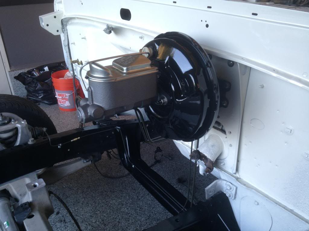

Assembled the master cylinder, booster and powdercoated brackets and got to work on plumbing all the brakes. Had a couple of wrong fittings but all in all I think it turned out nice. Here a couple shots of the whole mess on the firewall.
Really happy with the lines we ran. They all look great and are tucked up and out of the way. Master cylinder is painted with a coat of rustoleum hammered gray. I like the look of the raw master but know it would rust. This is the closest thing I have found to keeping it looking cast.

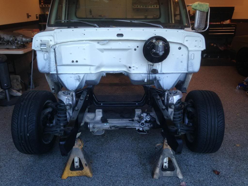

Not really worth pics but the front suspension all got pulled back off, front framerails all wire wheeled down to bare metal and metal etch primed, primered and shot with the same alk200 I shot the rear frame with.
Front brakes all got cleaned up, painted and installed along with new rotors.....Not wilwoods but 12.5" brakes look big on an old ford pickup.
Front sheetmetal is all pulled apart and bumper got straightened out and ready to head out to powdercoat along with the grille and headlight bezel.

curious what the master cylinder is from? I need one that ports from that side.
Thanks, Joe
