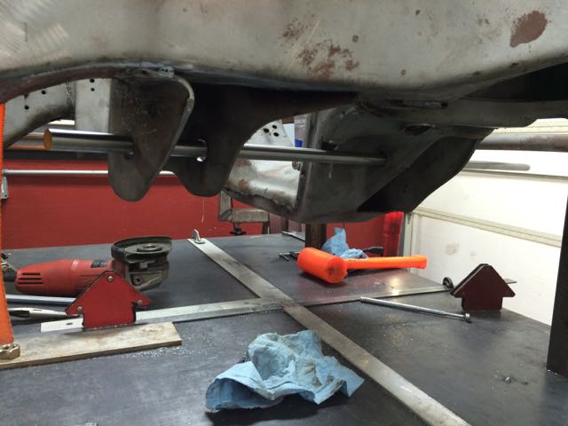

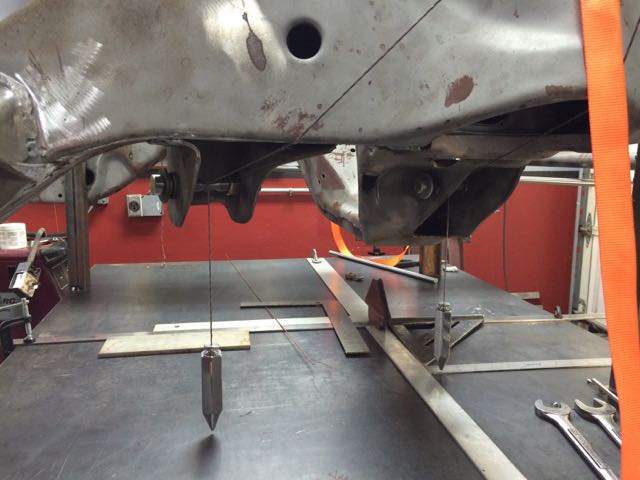

If I didn't already have the AFX spindle I would have gone with a custom one from Ron which would have made the geometry even better from what I recall with the conversations I had with him. The downfall for me is that I would have had to get new front brakes and a few other pieces which blew my budget.
Here are some more updates

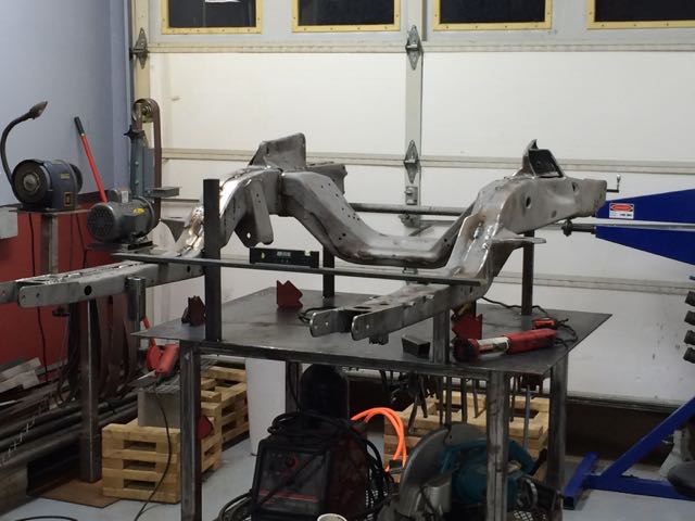

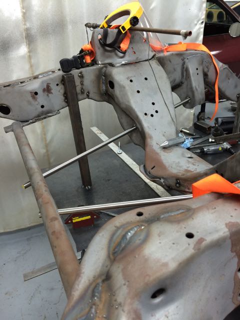

With the frame welded to the table in the same position as the car I needed to get started moving the LCA mounts. Overall I need to move the LCA mounts up 1/8" and make sure both sides are exactly the same.

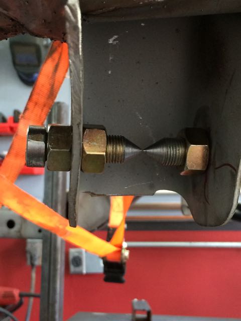

At first I decided to cut a few bolts in the lathe to make a point which would find the center points and hang strings from there. Quickly I found the issue was that the ante of the bolts could move relative to each other depending the angle of the factory mount which caused a lot of variability. I didn't like this.

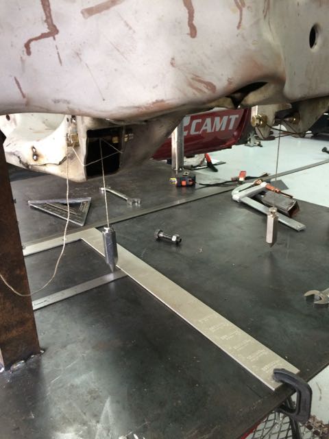

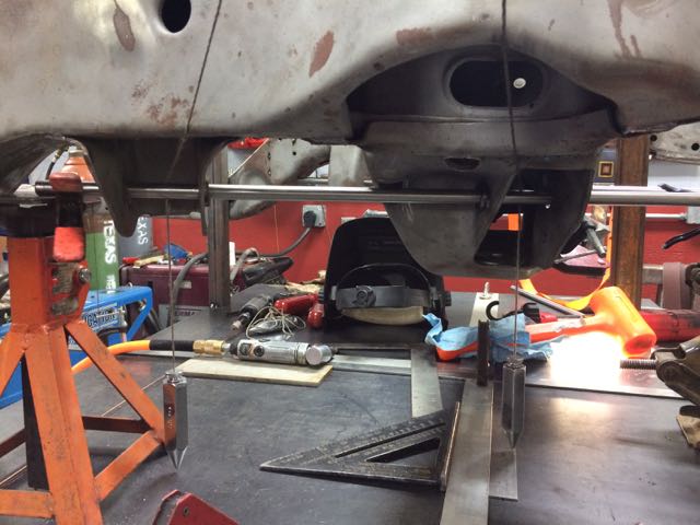

The plan already involved using steel rods to ensure alignment of the holes after they are moved. I decided to expand upon the use of this. I drilled 2 holes in the rods at the location of the LCA pivot centers so I could hang a string thru it and get the best possible measurement along with the most aligned mounts.

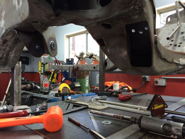

Once everything was where it needed to be hardened washers were then welded on to the frame so nothing would move. It doesn't look too hard in the pics but given it was my first time to do it, I had a lot of time measuring, grinding, remeasuring and regrinding....but finally I got it done.
Last night I also finished up the driver side so step one and hopefully one of the harder (most critical tolerances) is complete.
