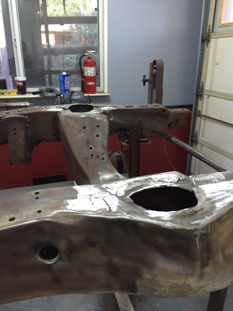

Another thing I am doing is moving the lower shock mount outward for better responsiveness. This is pretty scary for me since I'm no where near a professional welder/fab guy. Either way I already took the plunge and this is what I came up with over the weekend. Its a really tight fit but everything seems to work.

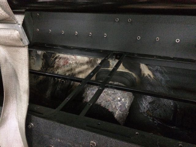

Not sure I mentioned it before but I did find something scary when pulling the car apart. The fuel vent must have been leaking inside the car. I could smell it once in a while when the tank was full but I though it was just a little bit of fumes. apparently it was coming out the vent and dripping in the car because the vent was angled and didn't reach too far out of the floors. Thats what I can gather from what I see. Either way there's no doubt that this will certainly be changed before the car gets back on any street or track

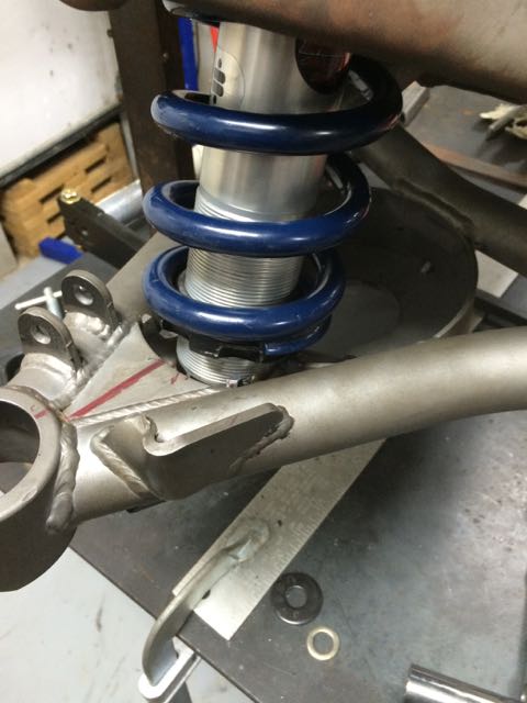

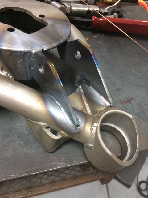

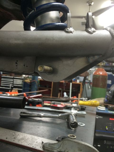

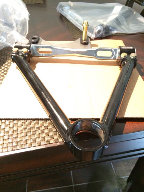

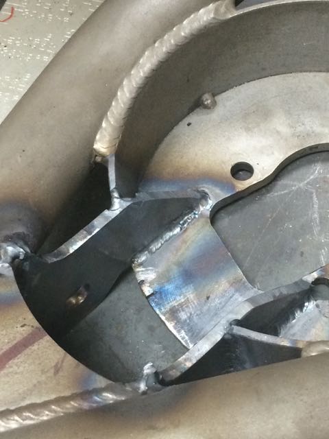

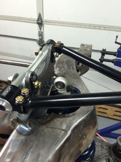

Here are a few more updates on the car. Progress is much slower than I hoped but I'm happy with the work I'm doing. At this point USCA at COTA is a no go. I did end up buying a completely stock 95 Mustang GT for next to nothing. I was going to run at COTA then later on turn it into a NASA CMC car but decided it too wasn't worth the effort/potential costs to run with USCA.

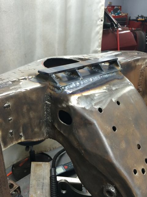

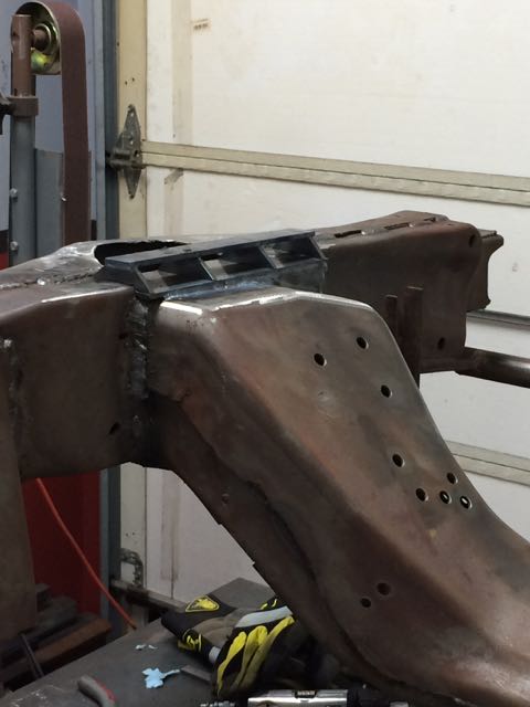

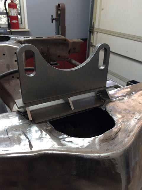

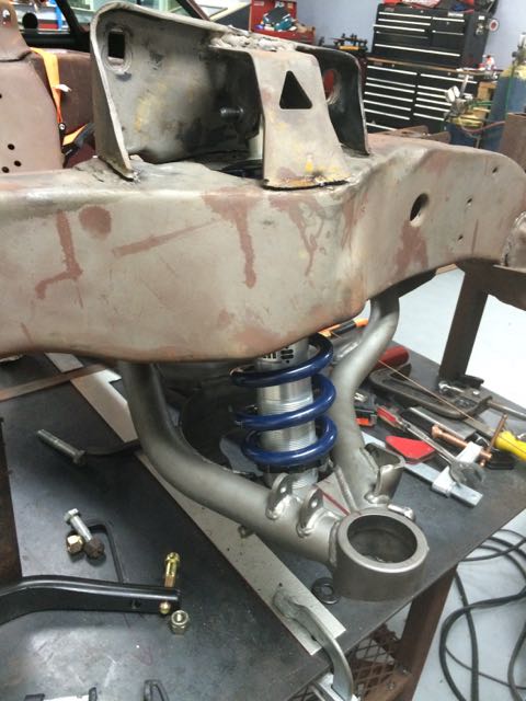

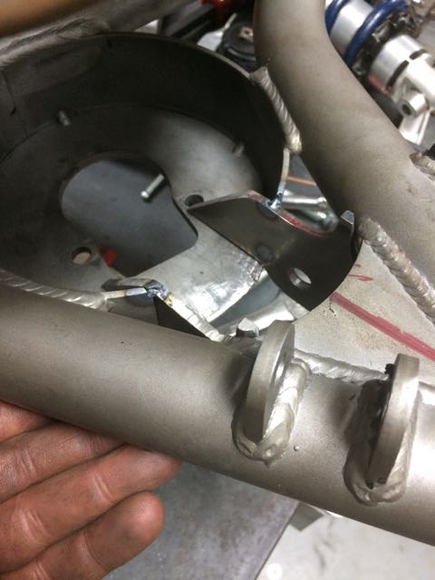

Custom UCA's arrived last week and I was able to setup the mounts. I built a platform with 3/16 that I will later box in and add gussets once I confirm everything is correct. I'll have the driver side done early next week.
I also need clearance the frame in the back for additional tire clearance and the bottom of the frame for the new sway bar. The bar is completely under the frame to maximize tire clearance. I'll post more pics of this once its complete next week
