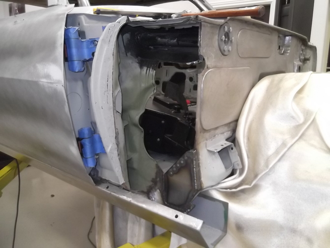

Started finishing the rockers.

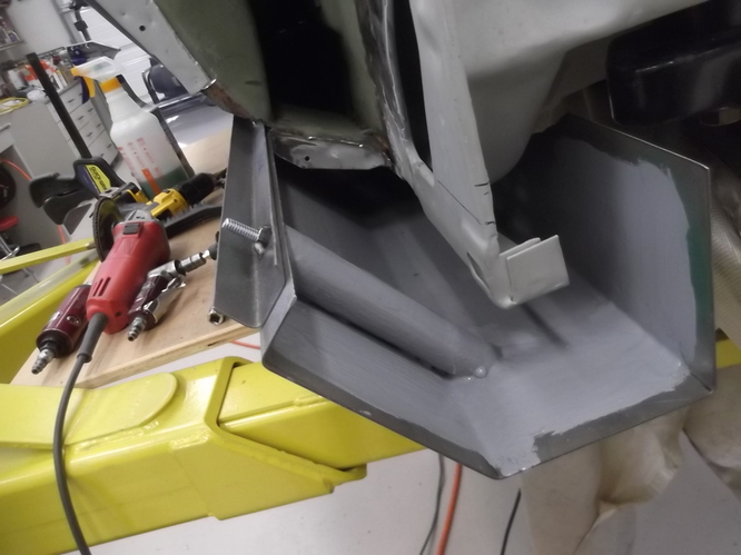

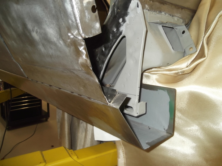

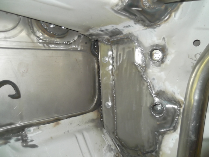

Combined the install of a 2.5 gallon oil tank with finishing the fab of the extended rocker panel. Thanks to many here...Steve, JJ, Tim McGilton and others for the concept and advice!
Used a 1" tube through the rocker to provide access for a bolt to attach the front fender. Even though I've done everything I can to eliminate any water from getting down here, I still prepped the metal to withstand the elements.

Had to push the tank into the interior just a bit.
Sealed off the rocker.

Sealed off the interior.
