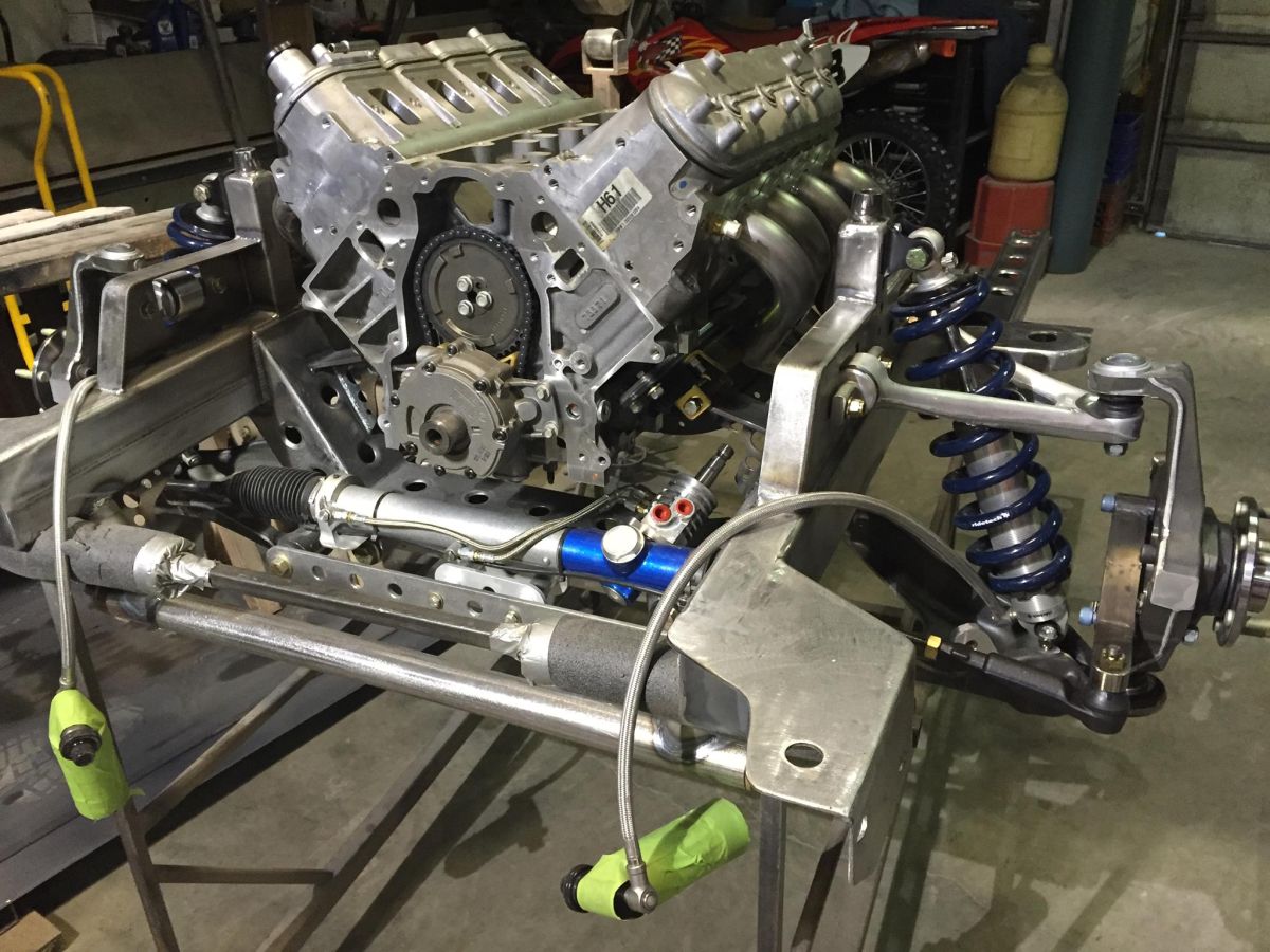

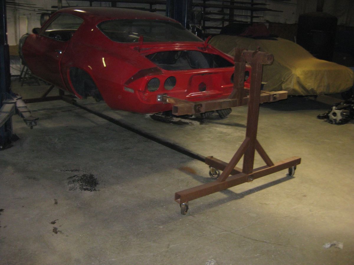

I also got to visit with my car. Scott's a genius, he made the best handling car, ever - The Hover Car - It uses repulsor technology.

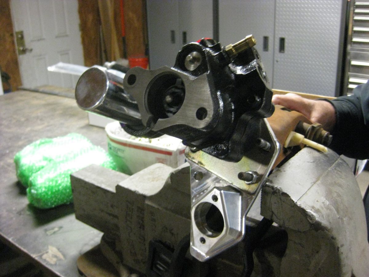

Actually, he has it on a cart to move around. Working in the "business" you have to hate customers like me. He spent a lot of time to disassemble the car with the nose on. When I visited, I focused on the ugliness that is the firewall... and had a might as well moment. Yep, the nose is coming off, so Scott can shave the firewall completely. We're moving the wiper motor to the driver's fender and have all new slave and master cyl brackets. Of course, the new motor is an LS, so the big honking coil goes away too.

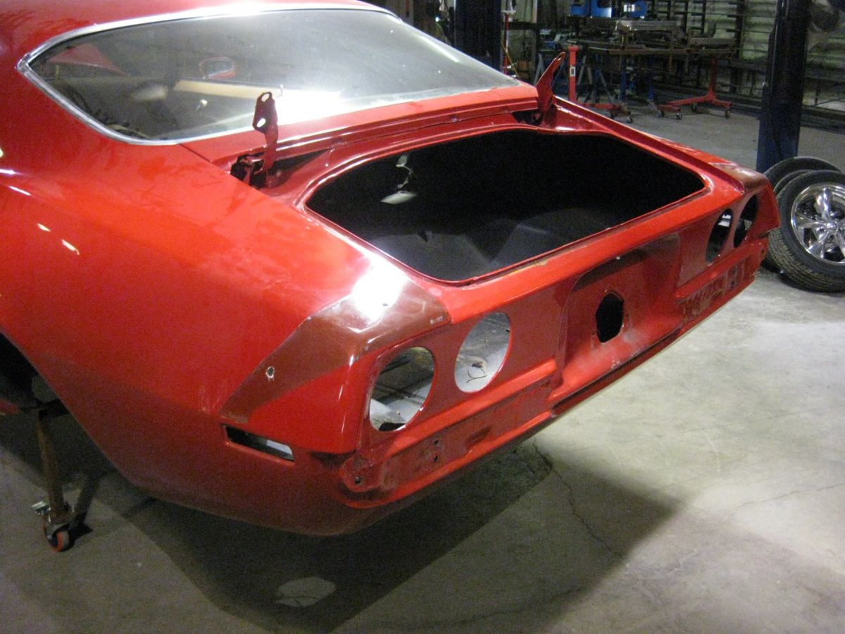

During dinner, after I visited, Scott let the cat out of the bag. The paint is hiding lots of ugliness. I never really looked at it, knew it was a plastic restoration, but 1/2" of Bondo is too much for me. Same with rusted trunk sections. Yep, another might as well moment - Scott is taking it all the way down to the shell and it's off to media blasting on Tuesday via Scott's rotisserie. When it gets back, Scott has two 1/4 panels and two trunk drop offs. He's re-working the rusty frame rails for the reworked IRS cradle, so that's a non-issue.

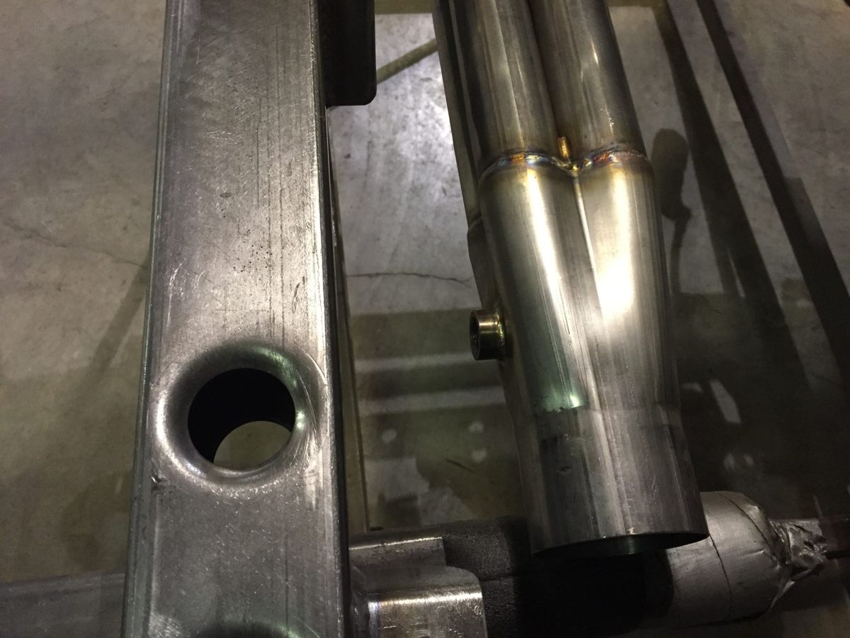

Oh and the stainless works headers have the 02 bung on the wrong side. These headers were for the Wayne Due chassis, which is not made anymore (that I know of), so they get a pass... Scott will TIG bungs on the other side and we'll cap these.

Silly question .... what difference which side the O2 sensors is on? I've never messed with them YET, thinking of putting them on my headers for sensors.

Can't fit an O2 sensor in on that side, we think...

Put a lightening hole there and you could probably get the o2 sensor in there.

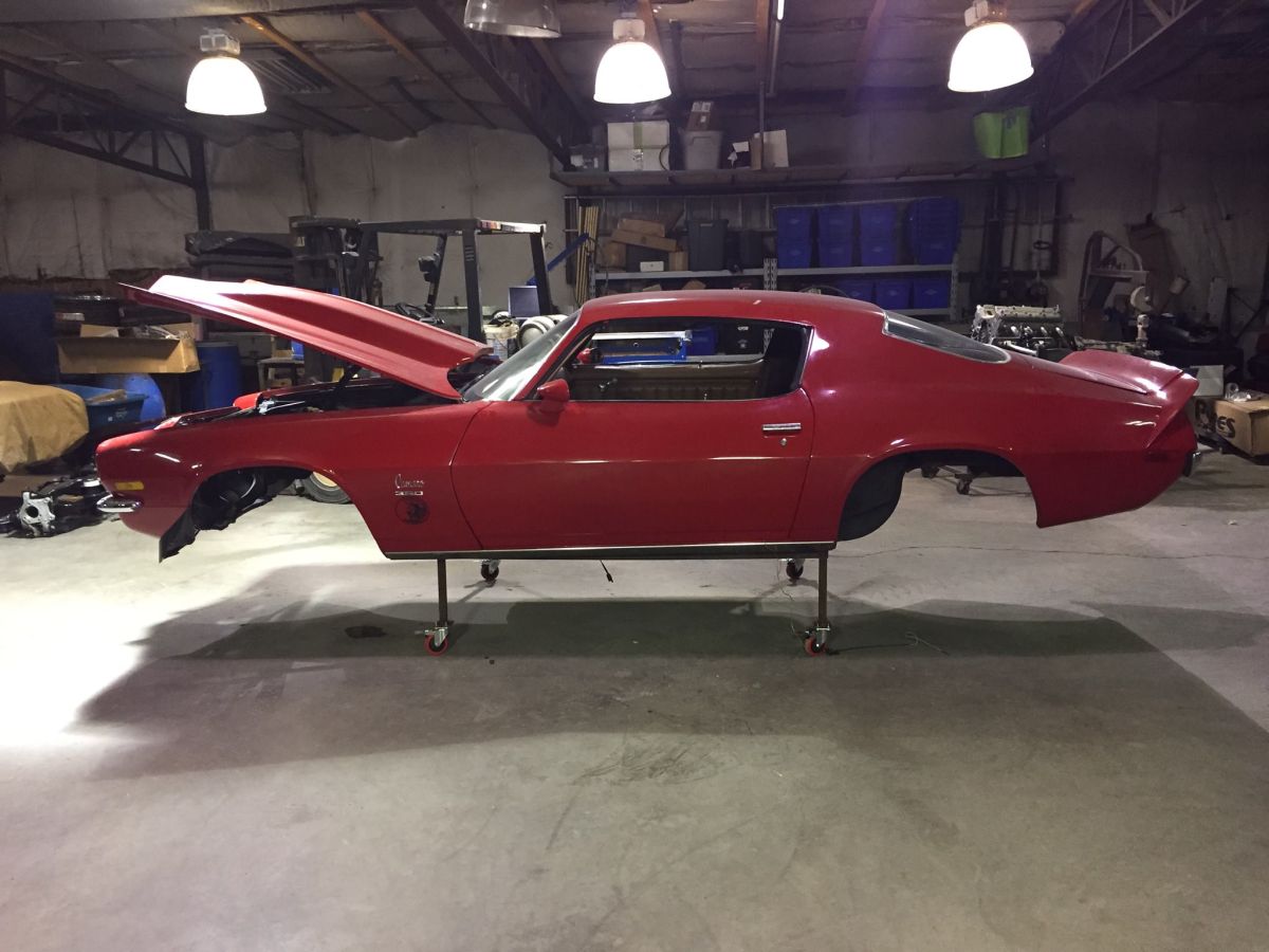

And it's on the rotisserie - wondering what we'll find under the mud, the blood and my tears.
(Hate this part, a pretty car becomes worthless when undressed, had to reference Johnny Cash)
