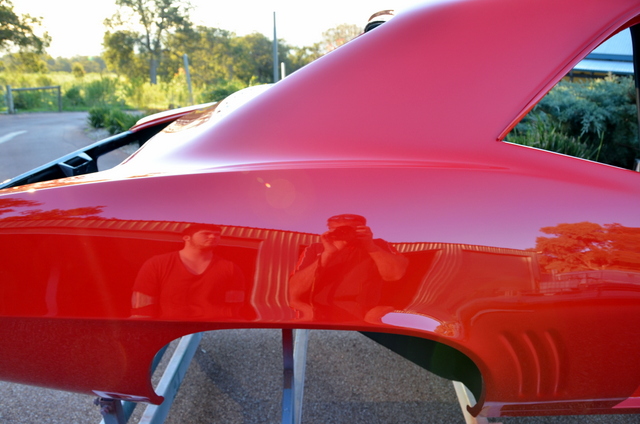

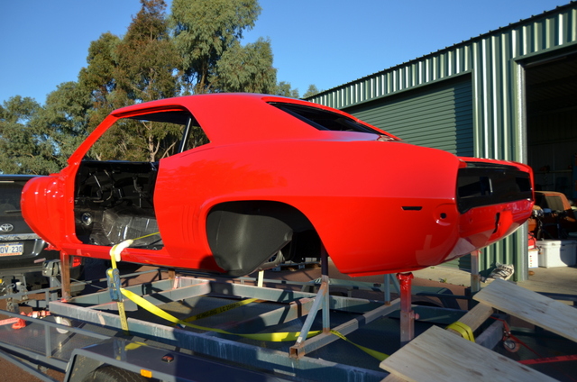

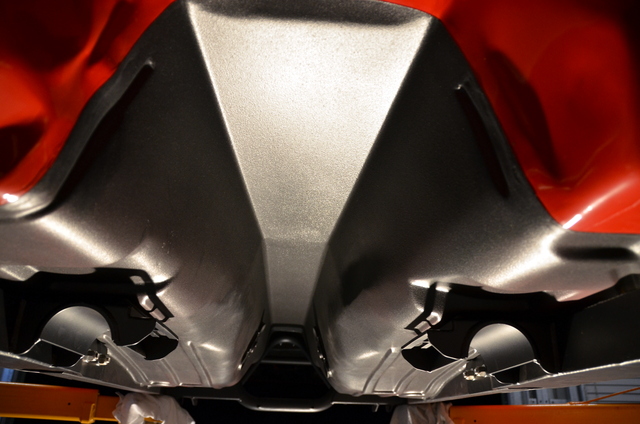

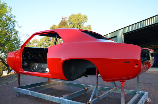

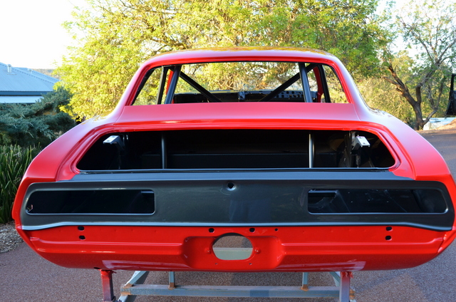

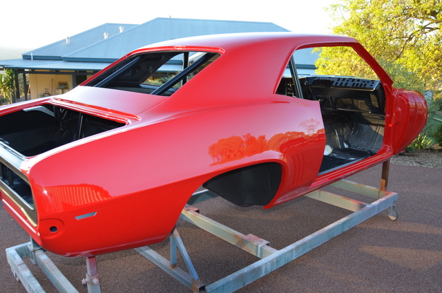

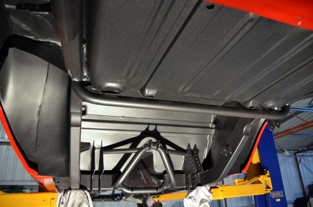

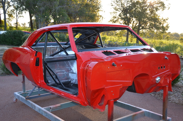

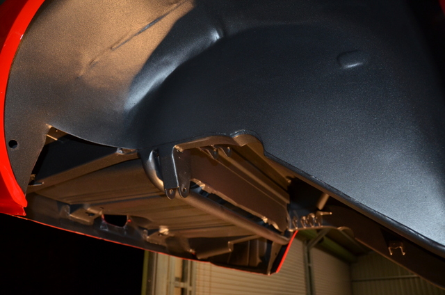

It's been moving along pretty well the last year.
Bringing it home after the firewall, interior and underside where painted.
The red is Sting Red, the interior is Matt Black and the underside is Gregorio Silverstone.
