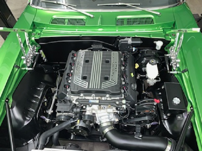

Awesome project! Did you have cut/ raise the transmission tunnel to get the right drivetrain angle?
Yes, cutting and raising the trans tunnel was needed. The T-56 is a BIG trans. I used the Holley motor and Trans Mounts which puts everything at the correct angle.
