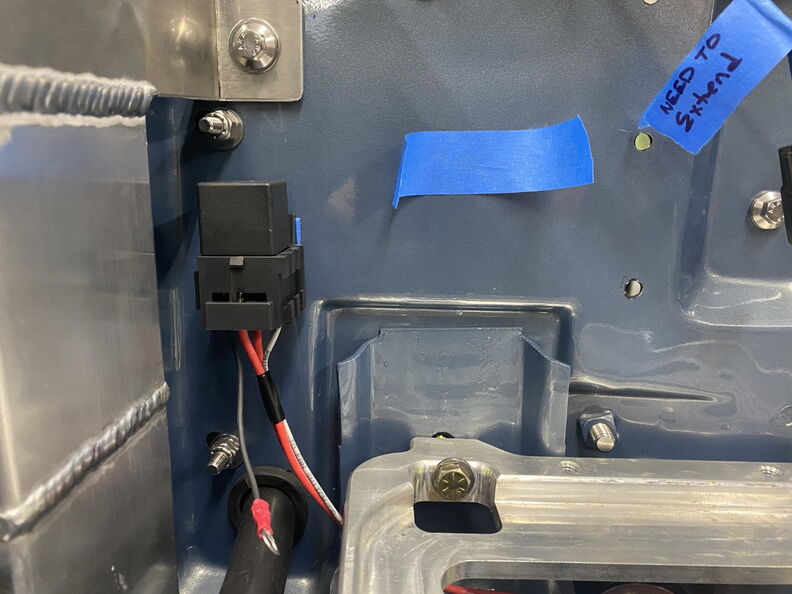

I removed the old wiring for the fan and installed a painless relay set up. Eventually this will come out and I will install the PWM setup.
I need to figure out the location for the relay.
This looks like the perfect location.
The black screw is the ground stud.
Wiring is all hidden nicely behind the battery
Remy Picture
Routing the wires over to the fan where I will install a weather pack connector.

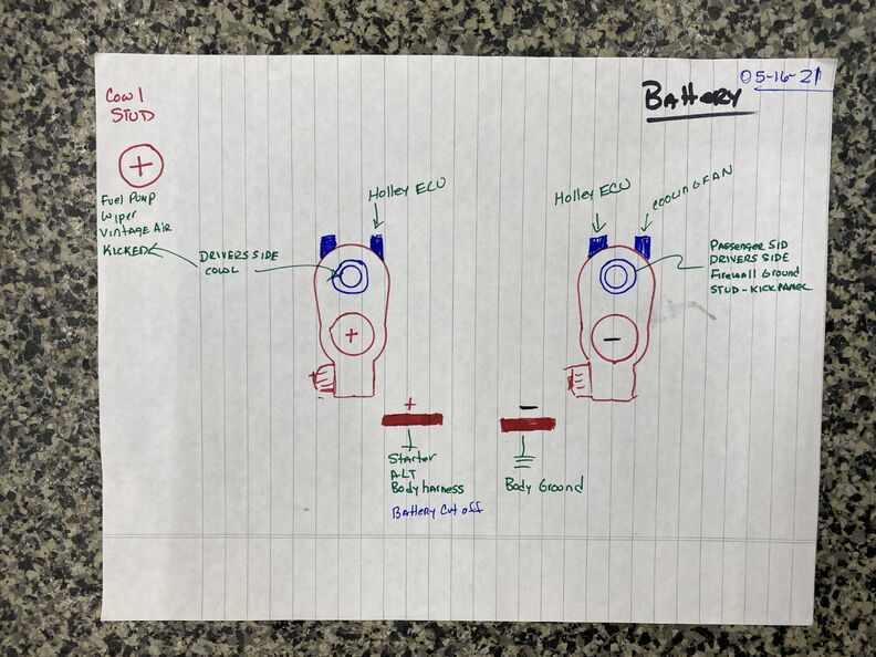

Default Making things looks pretty (05-16-21)
Time to wrap the wires
Breakfast & Relay
While I here I sketched out my wiring plan/diagram.
Of Course I will be using an Optima battery since the billet battery tray Ron & I designed for the 2nd Gen Camaro's.
more stuff !!!

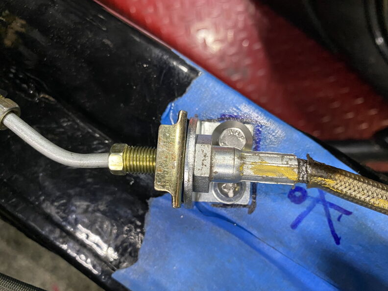

I needed to stop this bracket from twisting when I turn the wheel
Step One - Dill second hole in the bracket.
Step Two - Tap said hole.
Step Three - Drill second hole in frame.
Step Four - Mount bracket using the ARP bolt and then thread in the smaller bolt so it acts like a stud in the bracket. That way if the small bolt
breaks all I have to do is replace it. I also don't have to worry about breaking a small tap in the frame as I have done that some many times in
the past that I no longer trust myself.
Step Five - Rinse and Repeat on the Drivers Side
Yahoo I get to use my Right Hand Drill
That will definitely work. I've fallen in love with nutserts (rivet nuts) in cases like that, easy to install and work great for mounting brackets/etc. to frames, firewalls, fenderwells, sheet metal...

That's a great idea and what really sucks is I have the tool.
Da !!!!

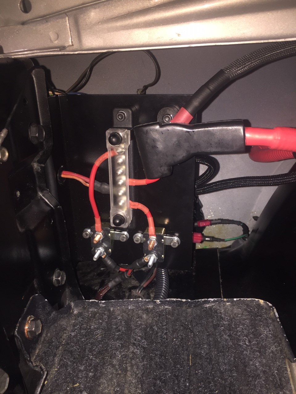

I've followed along at times and used some of your wiring techniques which has helped me, thanks for that. For my fan relays I decided to put them into a enclosure to protect from the elements just in case. One like this that fits both.
https://secure.sayal.com/STORE2/View_SHOP.php?SKU=14898
Then decided to grab this one of which I'll alter to fit down the road.
https://www.amazon.ca/gp/product/B07...0?ie=UTF8&th=1
Also fabbed up a panel into the front fender area so that I wouldn't clutter up the battery area with a bunch of wires. Also used 2 battery terminal blocks as extended power points. Rivnut tool came in handy here!

Looking back I should have used the waterproof relay, which means I will most likely order the waterproof relay kit and redo this next week unless Amazon can get it to me tomorrow.
https://www.summitracing.com/parts/prf-30130

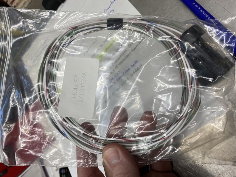

Default Holley EFI Wiring, does it ever end (05-30-21)
Yep, more wiring

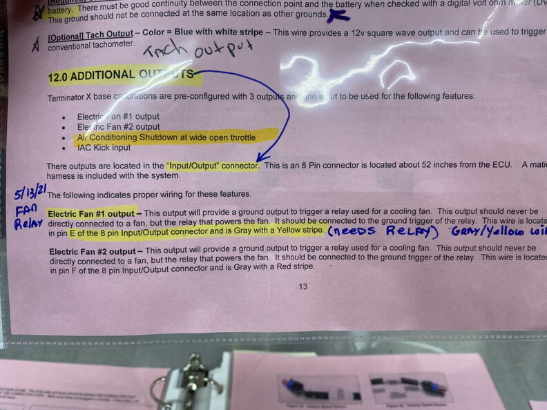

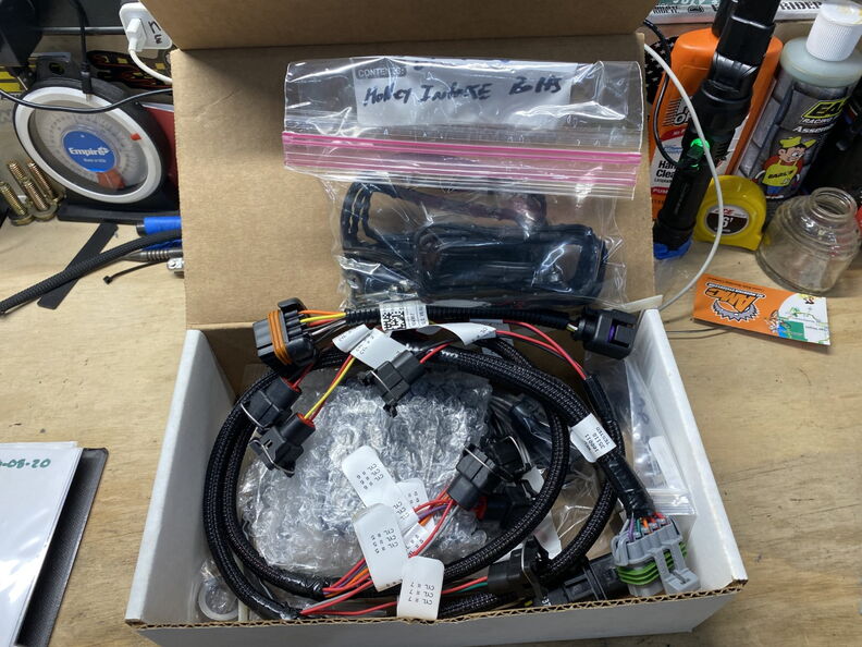

So way back on the 13th of May I wrote myself a note to look for this harness
found it
more notes
Holley Injector Harness ( 05-30-21)
Okay so I was hungry and I went inside and made myself some oatmeal and well I never realized how nice it looked.
In order to plug in the harness I will once again need to remove the Vintage Air unit.
Found it
He's getting bigger.

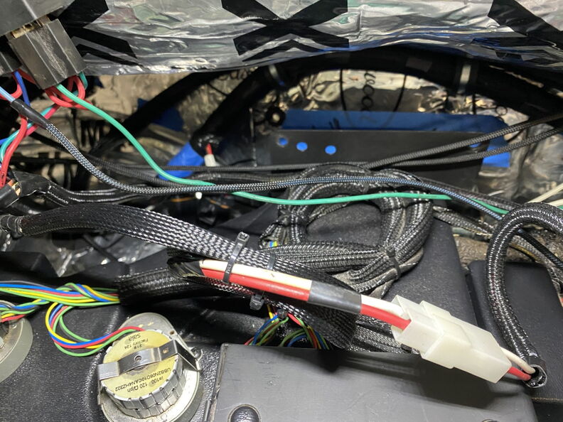

Moving on to the Holley Digital Dash
Connected and routed the wires so the Vintage Air unit it once again will go back in.
