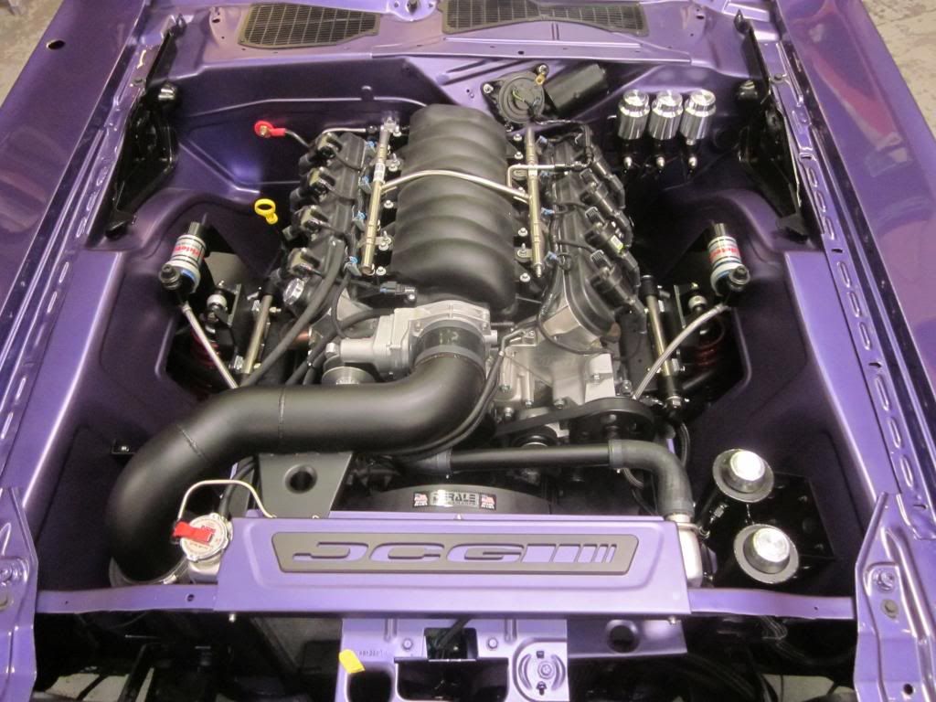

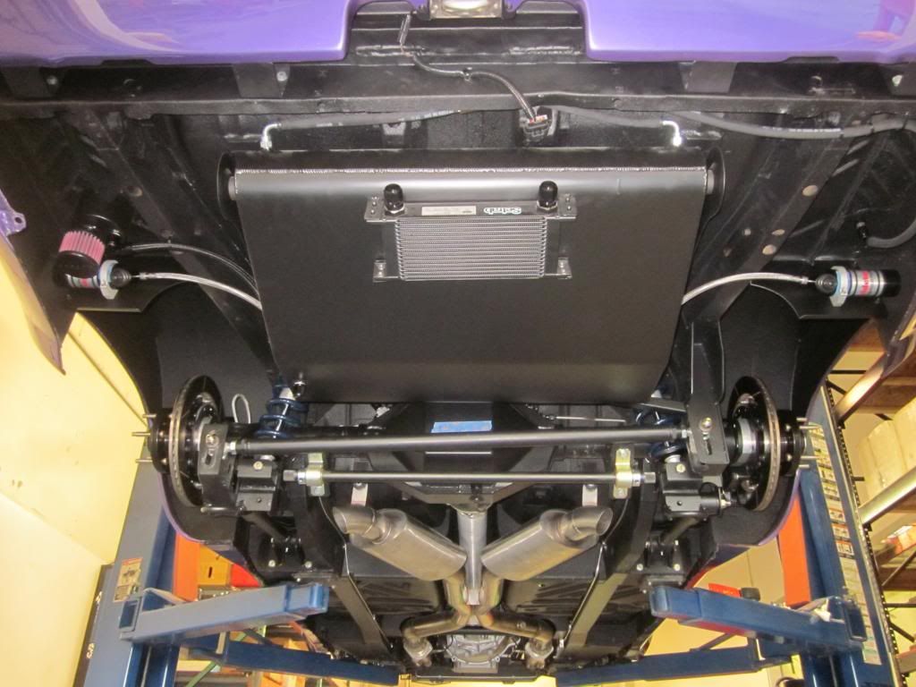

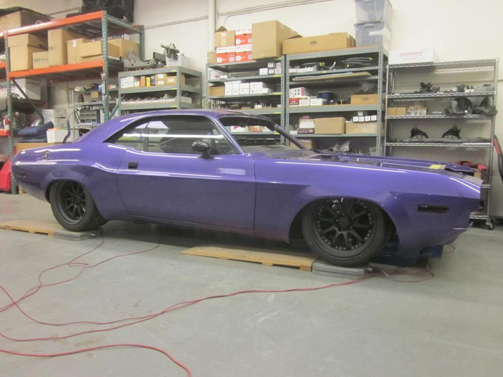

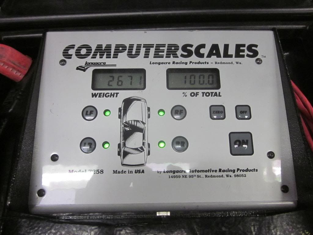

Here are a few...

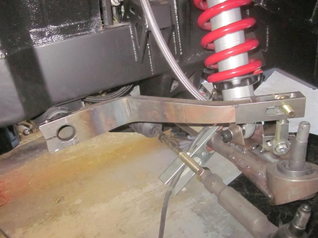

Car on scales
I think the car will end up @ 3100 lbs
Underside view..
Adjustable sway bar links...
Engine bay is complete..
Originally Posted by Al Moreno View Post
We need more pics!!! Looks awesome Cris
Cris Gonzalez
