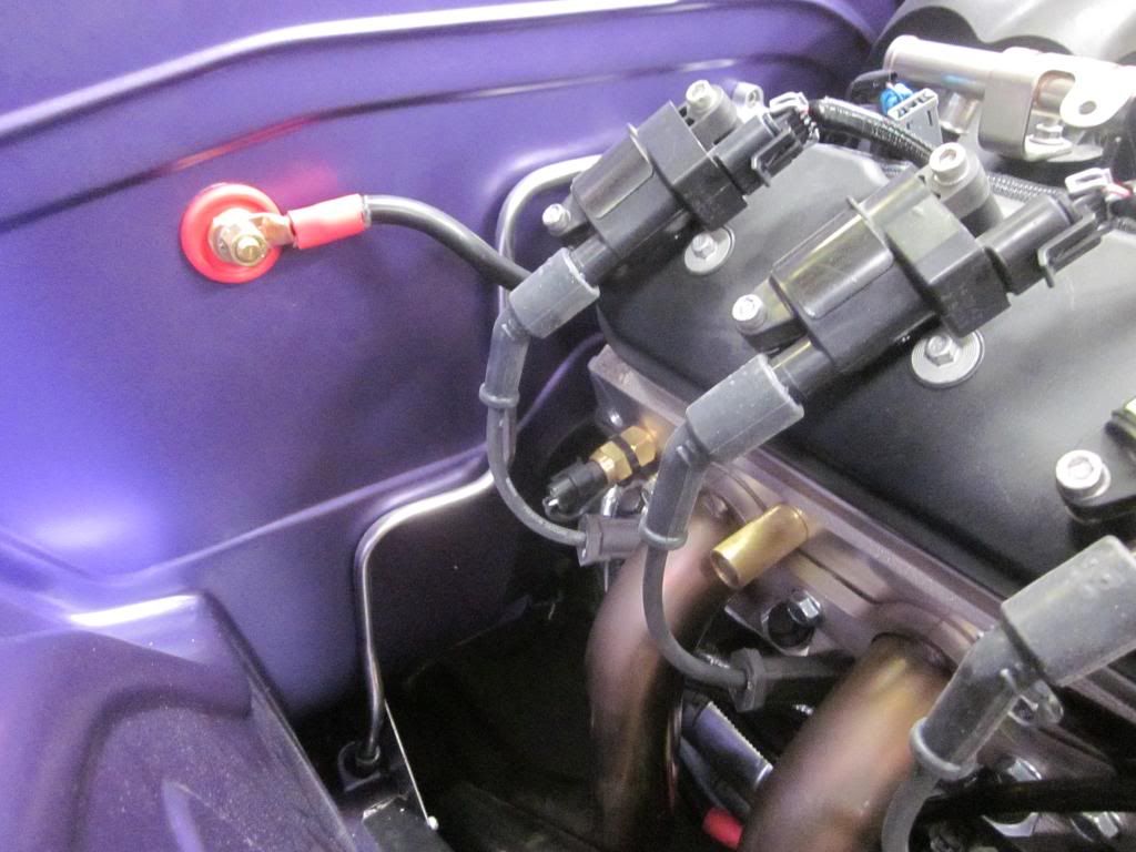

Here are a few...
Car on scales
I think the car will end up @ 3100 lbs
Underside view..
Adjustable sway bar links...
Engine bay is complete..
