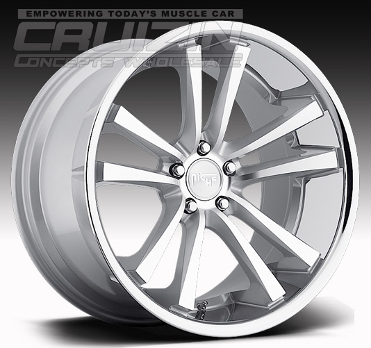

I love thse, but only come in 20x8.5 and 20x10 and 10 will not fit. Anybody know of a similiar wheel?

Why would they not fit? A 67'Camaro w a 10 inch wheell(tire too) i can see fit. Maybe not w a 295 but surely a stretched 275 or 285 w the right spacing.
Heck, Carl C's has 275 s all around if i remember correctly...

My car is not tubbed - I have 11 inched from inner tub to fender lip. A 10 inch wheel is 11 inches wide. I am going to roll the lip on the fender, but that only gives me about .5 inch. So, if i did a 10 inch wheel and found a wheel that I liked with the exact perfect offset/backspacing the tire would have to be exactly the same width as the rim. I think it's just too tight.
That brings up a good question though - anybody running a 9.5 or 9 inch rear and what backspacing are you using?
