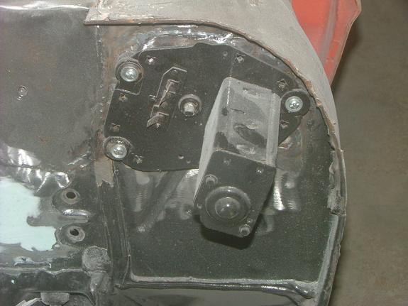

heres ashot of the wiper install

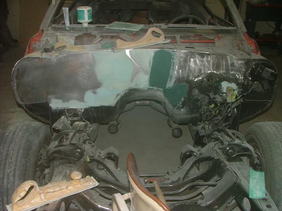

Here it is all done.
