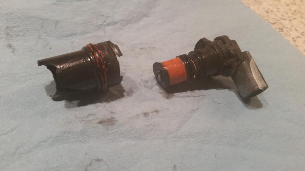

I have been chasing a tranny fluid leak for, well since the truck first started running so last year around this time.
I had pulled the pan once when it would not go into reverse and found some plastic in the rear park pawl. I straightened up the flange and put on a new seal to try and seal it up with no real luck.
I have been under the truck looking at it and cleaning it trying to find where the damn thing is leaking, it was not the tranny pan from what I could tell, it looked like it was above that as I had fluid above there. Lots of suggestions to replace the internal harness but I was getting lo leaks there.

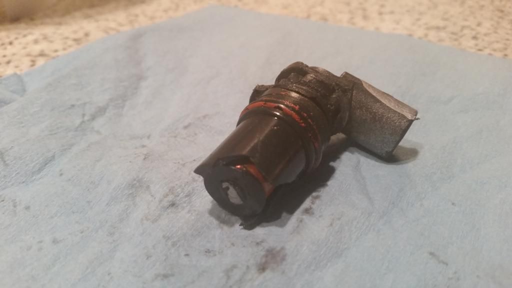

I picked up a tiny hint of fluid around the output VSS sensor so last week I picked one up.
Had a little time this morning and was dreading what I was going to find tackling this on the garage floor.

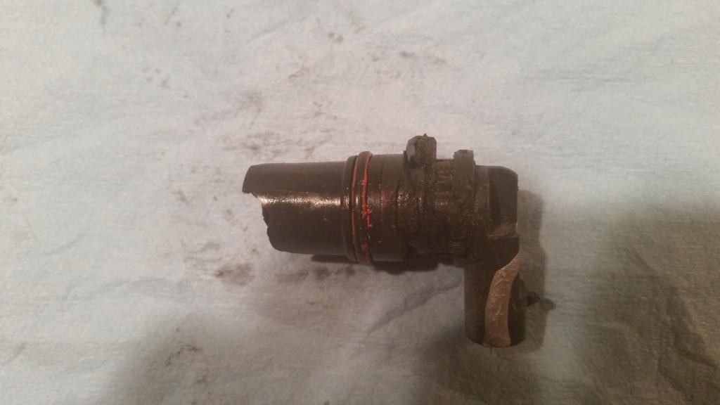

So I jacked up the truck and popped out the VSS sensor, well I took out the sensor part of it. It was obviously broken at some point before I got the transmission and I neglected to figure this out a while ago.
Here is what I took out.
Got both parts out, cleaned things up, put the new sender in and took the old girl for a spin. Checked it after I got back and it was dry as a bone. Checked it just now, still dry.
Good news all around, the plastic parts I found earlier in the pan, from this sensor. The leak fixed. and all back to normal.

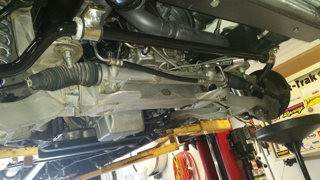

Ordered up an ADDCO sway bar and got it unboxed yesterday. I was pretty disspointed with the finish on the bar, it was chipped and scratched up before I even got the bubble wrap off of it. If you look at it wrong the paint just falls of. Seems like for what they charge they could have powdercoated it or something, it is just crappy paint, not even a primer on it or anything.
I guess I will need to pull it out after I get it all installed and get it powdercoated.....just what I was hoping to do with a finished part.
Looks like it will fit, I drilled the holes in the frame yesterday and got it close, I have to put a thin spacer underneath the bar to clear the flexible coupling on the turbo crossover pipe as it just touches the bar at ride height.
I picked up some 1/4" plate and 3/8" plate to build spacers out of today 1.5" wide. It should be about perfect.

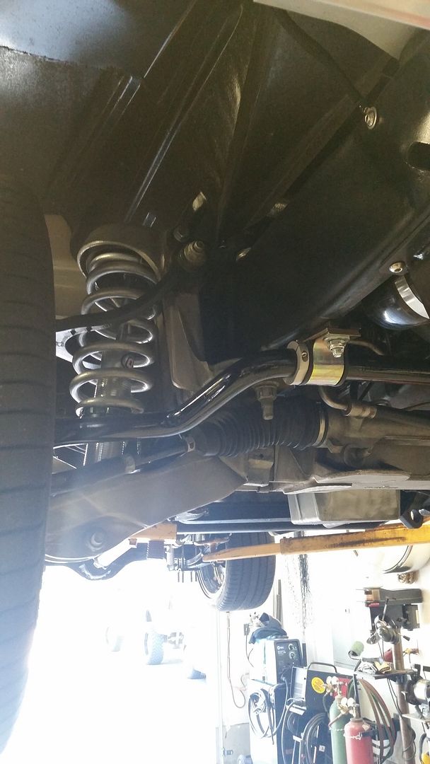

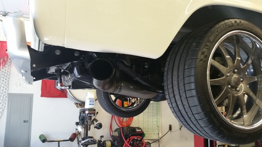

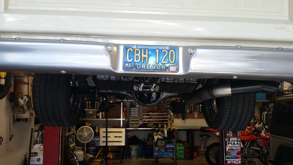

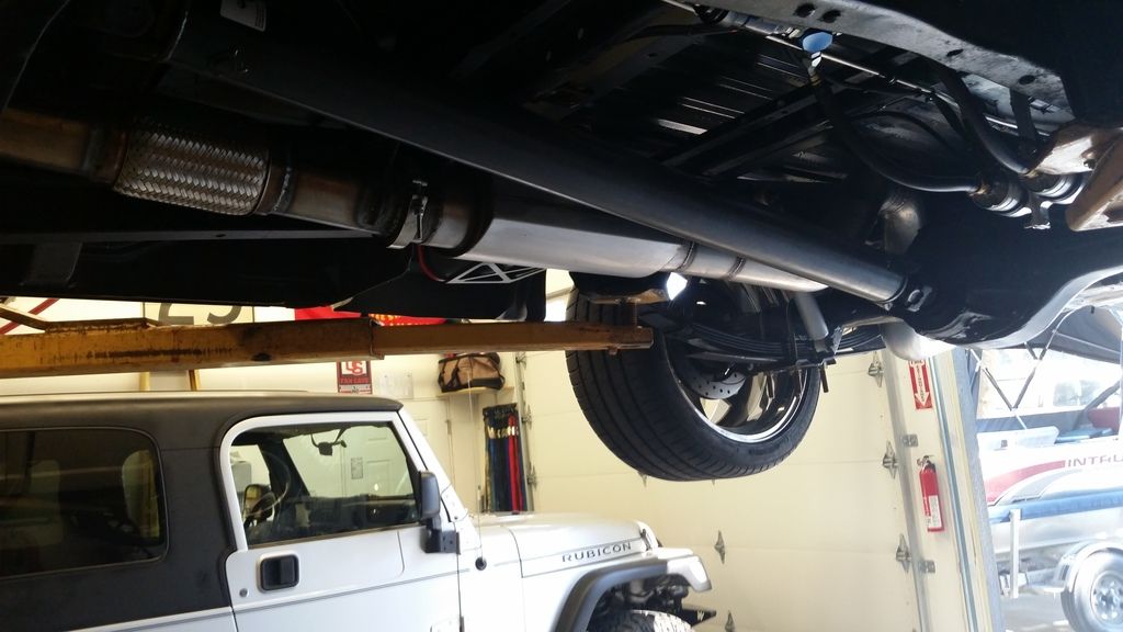

Gettting the truck ready for the Portland Roadster show coming up in just a few short weeks. I spent a good portion of the last weekend with the truck up on the lift just cleaning and detailing the underside of it. Looks like I have all the leaks fixed. Cleaned up a few electrical connections with some zip ties and just general tidying up. Things still look good under there.
Also got the sway bar all painted and the front suspension cleaned up. It actually cleans up nicely. Here are a few underbelly shots of the old girl.
Its not spotless but its pretty damn clean under there for an old truck.....my hands were damn tired.

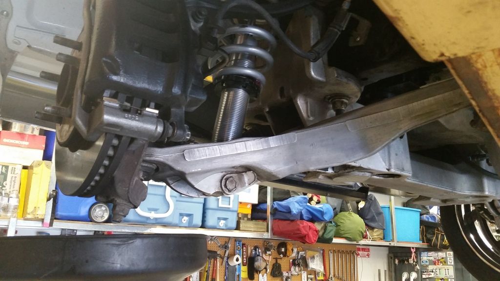

Then on Monday, my new brake setup showed up. Here is the stock Crown Vic setup on still...

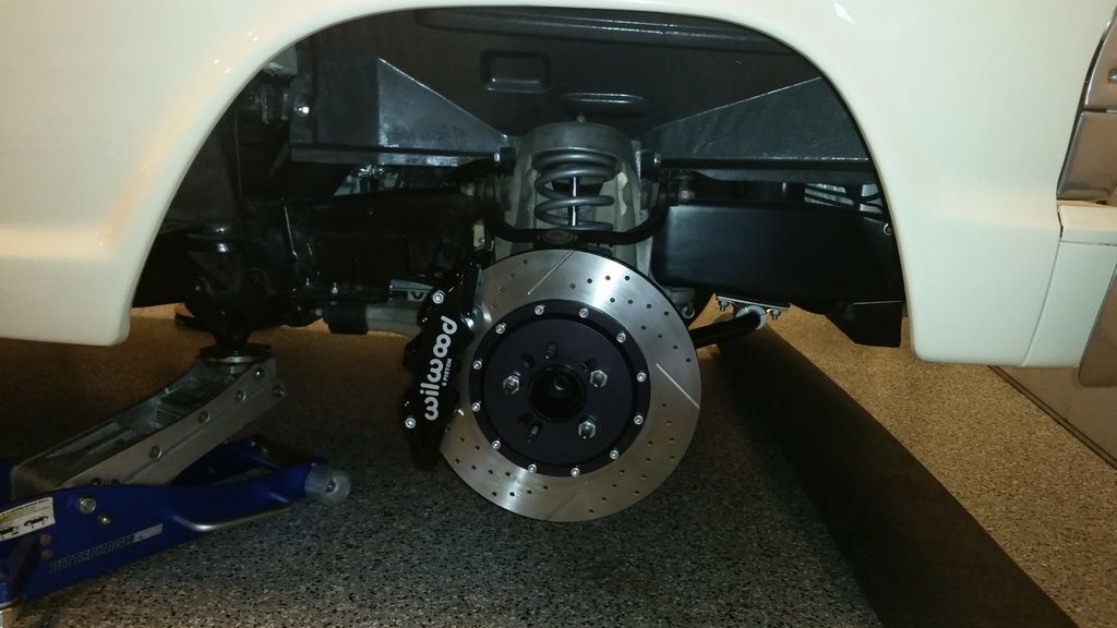

New front setup from Todd at TCE Brakes. Amazing stuff from him and I would recommend him in a heartbeat. Wilwood AERO 6 black caliper, stainless lines, cross drilled and vented two piece 14" 1.25" rotor with aluminum hat......turns out I had room for the 15" rotors. Should have just committed to them earlier.
This is just mocked up on there. Still need to plumb and deal with the raw rotor finish. Hope to have this all buttoned up Saturday.

I'll tell ya the same thing I tell my guys....trim your F'ing all thread! (U bolts) I've got a headache just looking at it!
Truck looks great Sean, wheels, brakes everything about it is spot on!

Front brakes went very well......I have no idea if they stop or not yet though.
Todd at TCE is the man. Everything bolted together very nicely and had no issues at all. Pedal feel is excellent so far.
Some goodness in this photo...
