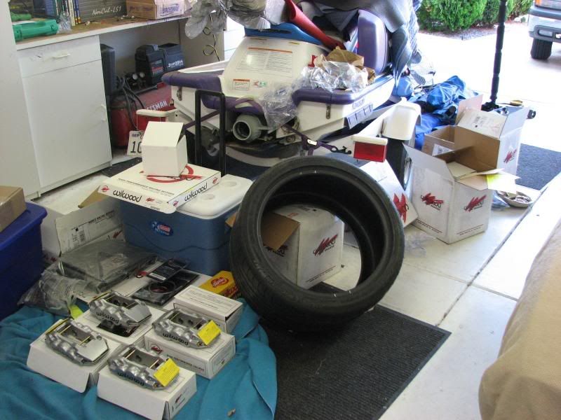

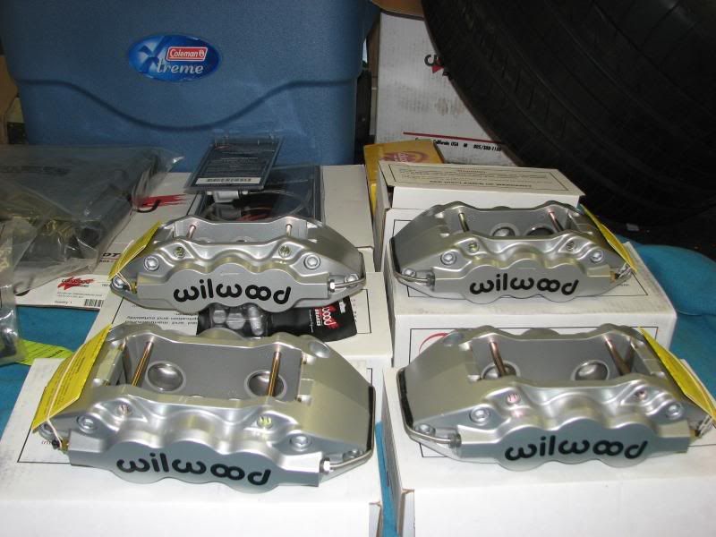

Time for some new pix.....
Well it was a Wilwood Xmas again !!!! Last time I just got my hubs, hats, rotors etc..... my caliper came alittle later. They are fricking awesome....and huge !!!! They are the W6A 6 piston with the optional silver color.
Wilwood still needs to make the caliper mounts for my application on the front. I dont have my Dana 60 yet for the rear, so I cant mount the rear stuff yet since the mock up rearend is way different.
