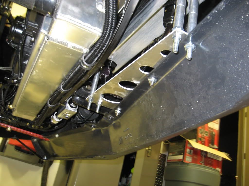

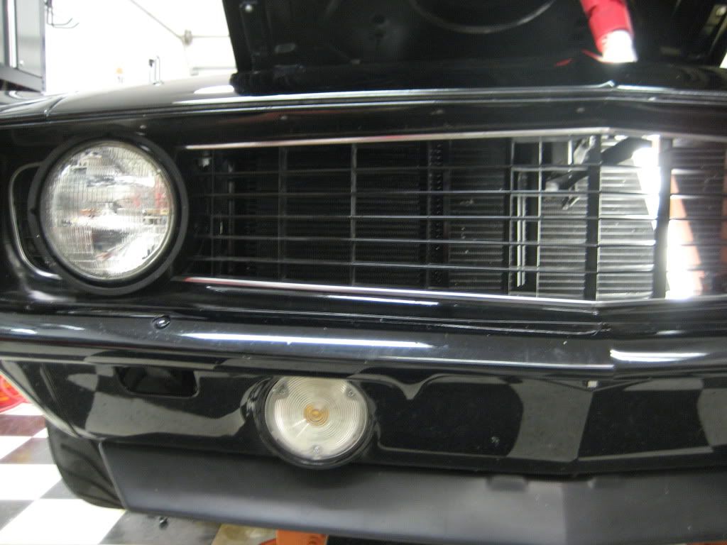

First, let me say that she's a dirty pig right now. I've been busting my ASS trying to get it ready for a local SCCA autocross tomorrow. Rumor has it that it's the biggest lot we've ever run in at the speedway. As most of you know, my oil temps were hitting 275 at Buttonwillow. That doesn't make a guy feel to warm and fuzzy. So in typical fashion, I buy the 2nd biggest oil cooler Earls makes.(50 or 52 row) It was like stuffing a square peg in a round hole. I built a bracket and the oil hoses wouldn't clear the front facia. I built that bracket on the same angle as the grill. Then I designed a bracket that would put the oil cooler square to the radiator. It turned out bitchin. I had to re do my entire oil system. I moved the sender out to the oil t-stat. The oil lines go in around the Z bar area and it's a tight bitch with the 2 1/8" headers coming in to clear the steering shaft. I'm stoked with how it turned out. I'm going to redo the top aluminum cover plate and the hardware will change. I just flat ran out of time. My oil pressure is up 10-15% over the old set up. I don't know if it's from moving the sender or the heat exchanger was that restrictive. Dad and I took it around town today and it's definitely running 10-15 degrees cooler in traffic. I think it's going to work well in the summer and on the road course. I'm a little concerned with the cold weather cruise condition. I may fabricate up a cover for the oil cooler. The t stat is working but I think it's still doing some cooling just being full of oil. I switched over to Redline 15w-50 and it now takes 13 qts for an oil change.
One of my major goals was NOT to cover up a majority of the radiator but allow enough room between the core and radiator support for flow. It's a god mix of flow through the oil cooler, condensor, radiator, and through the oil cooler and into the radiator support and where ever the air wants to go.

Oh yeah, I pulled the jabroni move of the century. I drilled a hole in my radiator. I was to lazy to remove the radiator. Long story short, I had about a half inch and was enlarging the t stat holes and went a little deep. It's epoxied up so it's getting replaced after this race. It will only be the 3rd radiator in this car.
