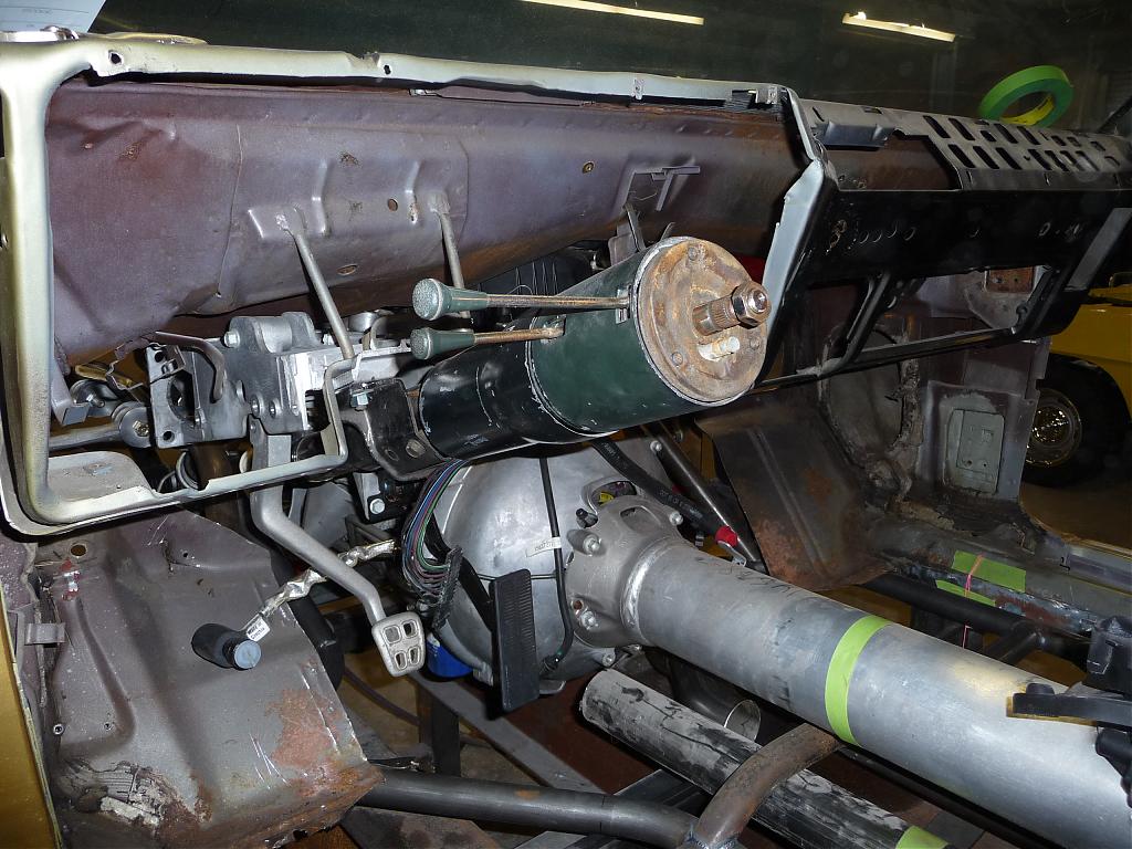

Mark Williams made the axles. The stock ones were .060 to small to respline. a little pricie because they had not done any yet. Something else pretty cool, the peddals out of a c-6 brake,clutch and gas fit pretty nicely in a first gen.without much mods and moves the corvette booster over 3 inchs for more motor clearence

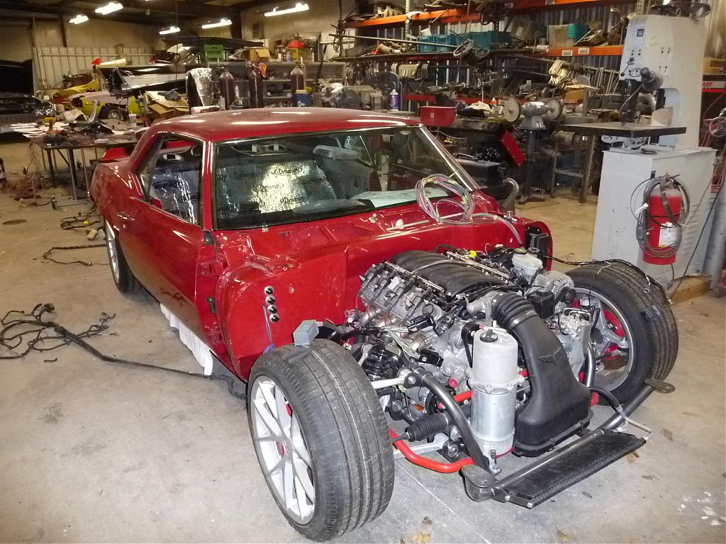

I've taken the stock corvette complete wiring and spent MANY hours weeding the unneeded wires. I'm using the ABS,traction control,heated seats,power seats out of the corvette,keyless start,power door locks with electric door latches,and the corvette guages with digital display. I'ts taken me 3 months to wire it and now i'm cross eyed. Bob

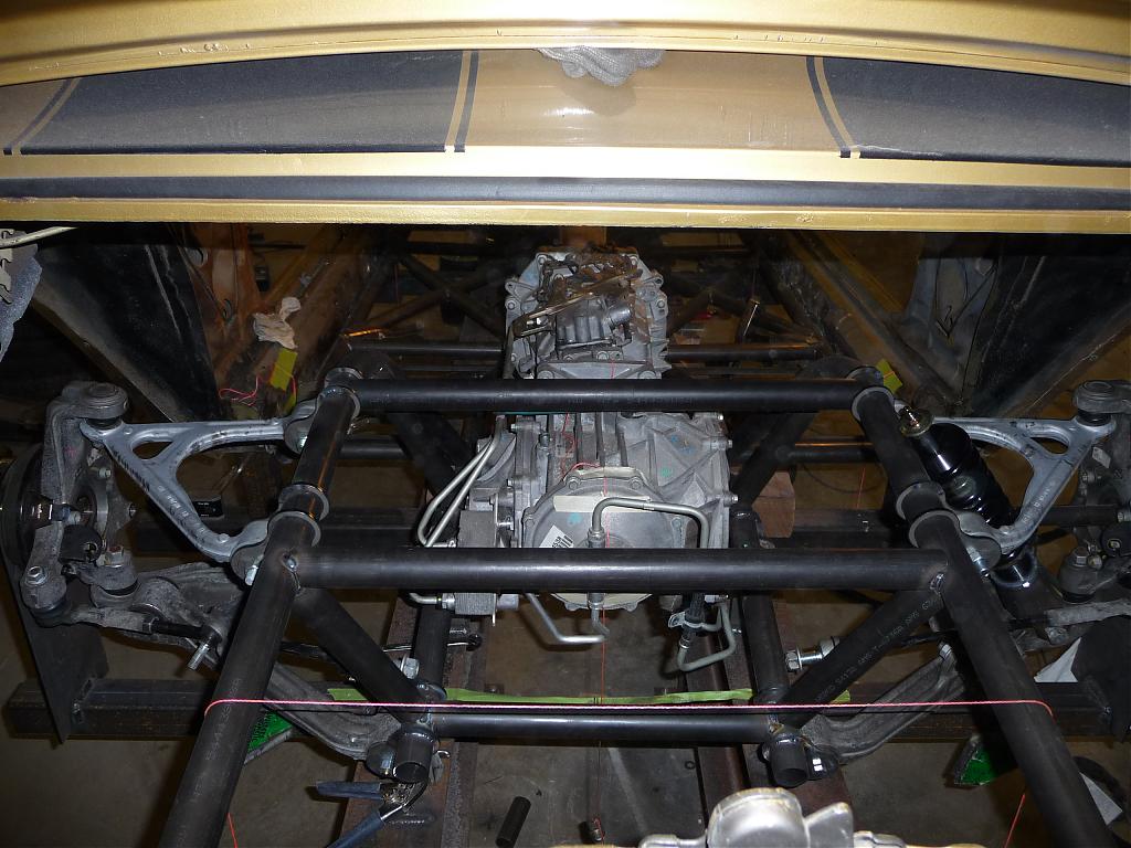

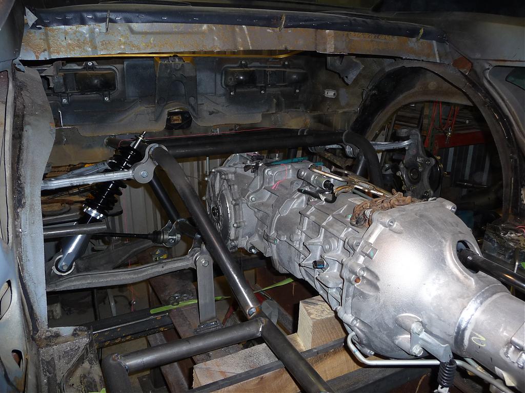

A couple more pics. I'm about done with it so i'm jumping back and forth
