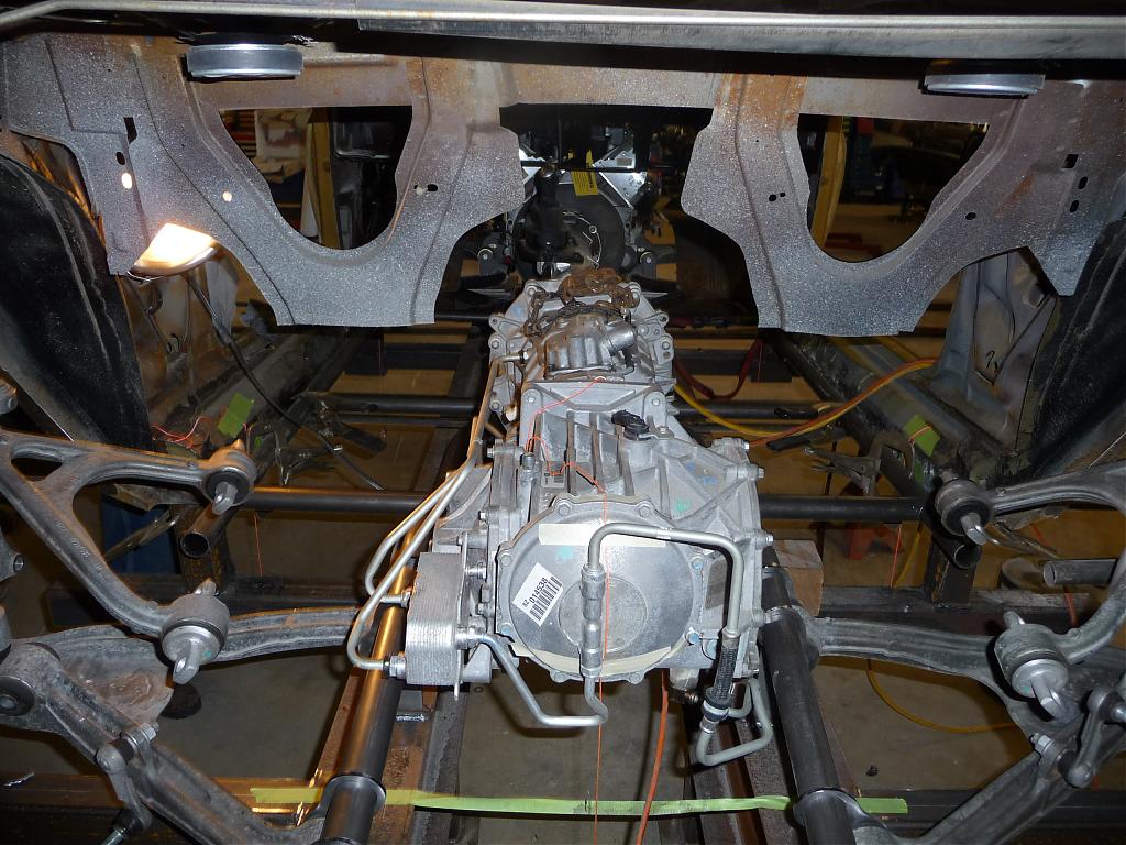

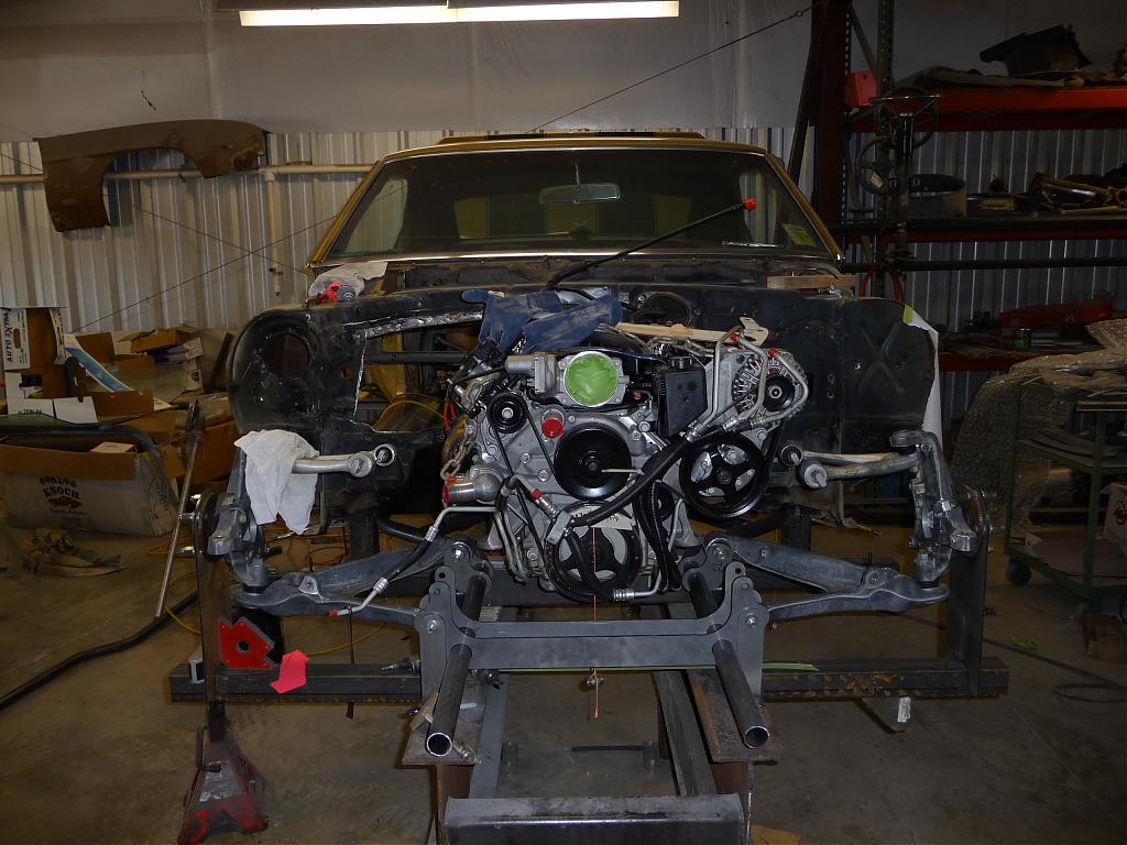

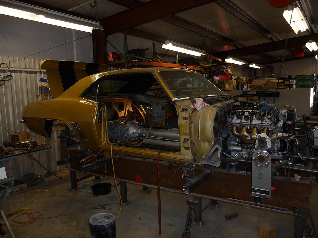

How about a 69' with a complete 2008 Z-06 running gear and suspension? How about a full crome moly chassie? I being building on it for a little over a year and it's almost done. I'm not much for posting and posting pics so bear with me and i'll do the best I can Thank's Bob

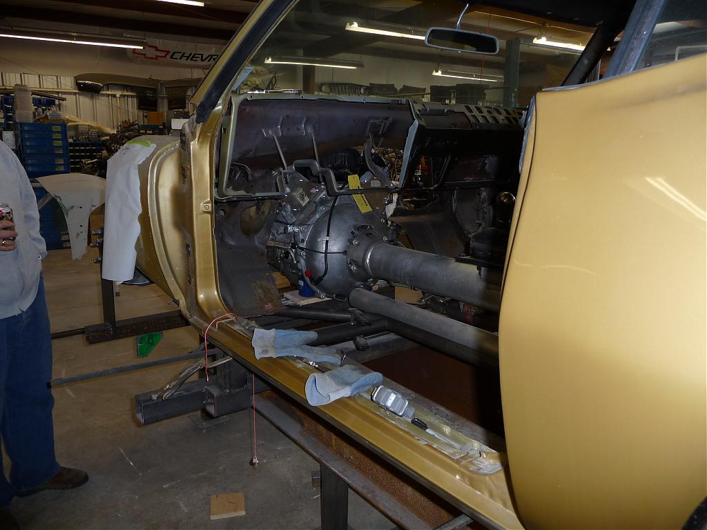

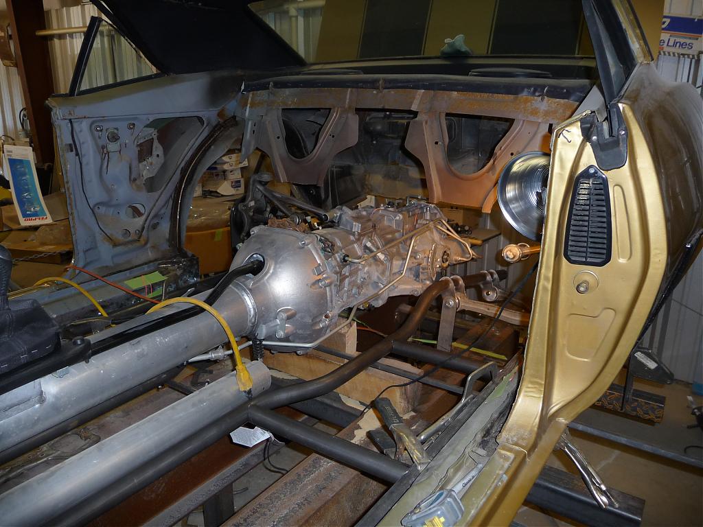

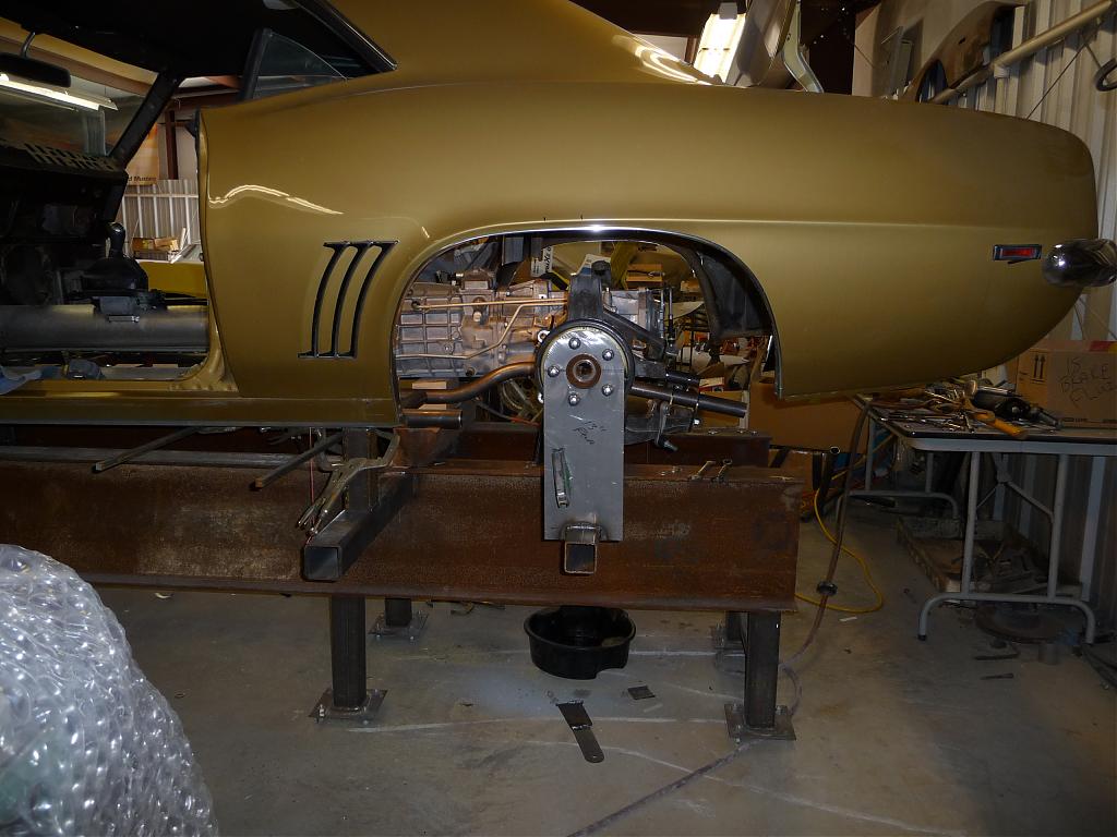

The car I started with was a nice virgin sheet metal car and saved alot of time. I bot a complete drive train and the wheel base is within 1 in. of a stock camaro so the tork tube did'nt have to be modified. The tracking width is wider so it had to be narrowed and new rear axles had to be made.

Now that's awesome. How much did you have to narrow it up?

If I remember it was like 3 and a half on front and 5 on rear. I used the stock Z-06 wheels and they have alot of offset I don't think you could ever get it in far enough to put a conv. style wheel Thank's Bob

I new there had to be someone out there doing this. What about the transverse leafs? How did you narrow them?
