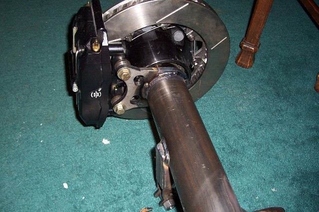

Old setup: Procharged/intercooled/EFI 353 SBC, TKO, ATS/SPC/Global West suspension, C6 brakes & hydroboost.
In progress: LS2, 3.0 Whipple, T56 Magnum, torque arm & watts link, Wilwood Aero6/4 brakes, Mk60 ABS, Vaporworx, floater 9" rear, etc.

Well... he could use a floater axle. That should take care of any remaining power handling issues

From their website the Lateral Dynamics 3-link is not available for the A-body. Have a call in to them to see about custom apps but haven't heard back yet. Please explain floater axle...not familiar with this term....??? I also plan to have a set of 15x10 rears for screwing around at the strip with drag slicks....engine will be capable of 1800hp on race gas and of course I'll have to try this out even though the car will be used 99% street.
