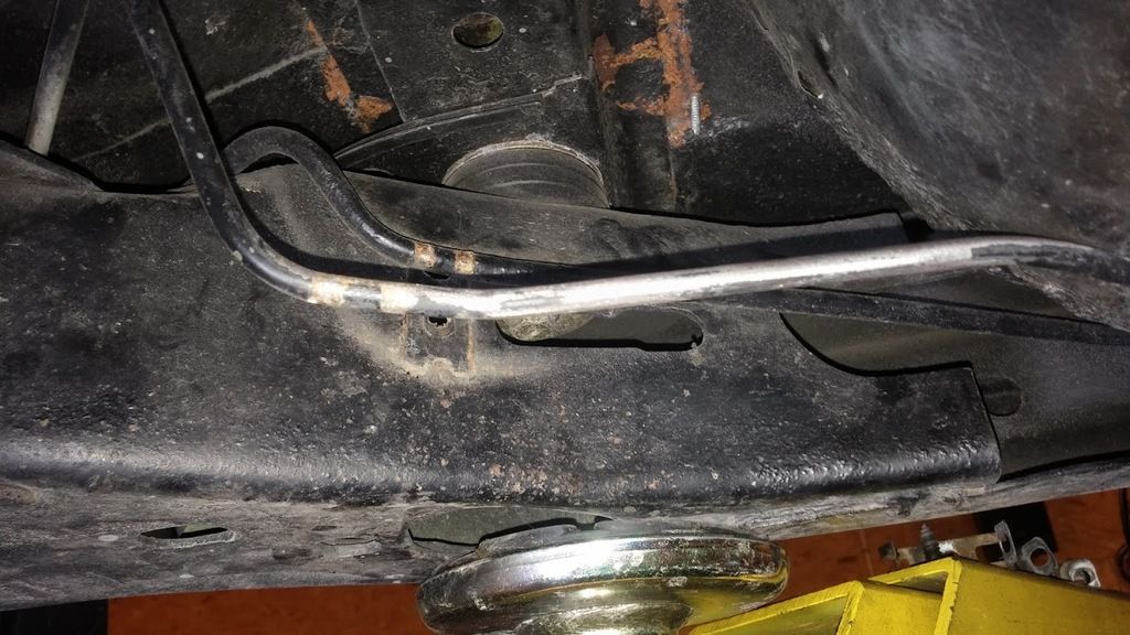

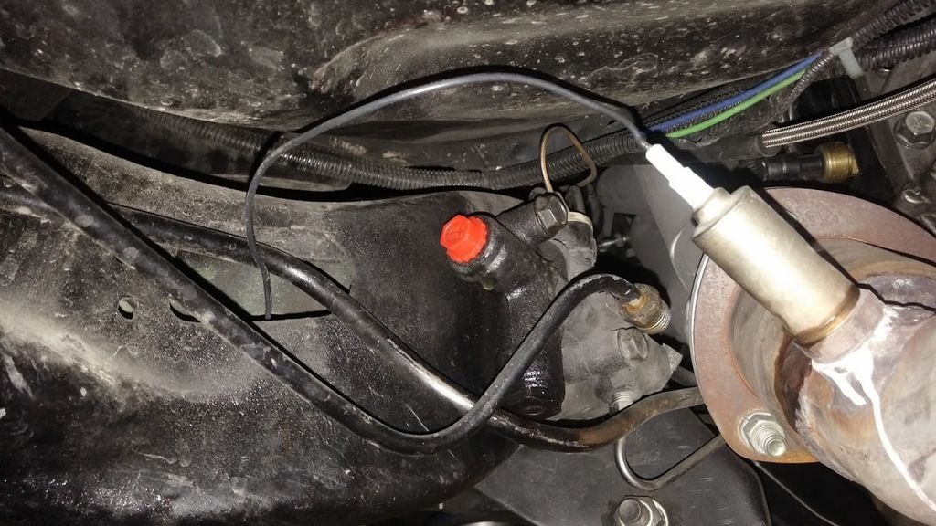

Then Sunday I tackled installing an adjustable proportioning valve in the rear brake line. First I disconnected the hard line from the distribution block and put a plug in the hole.

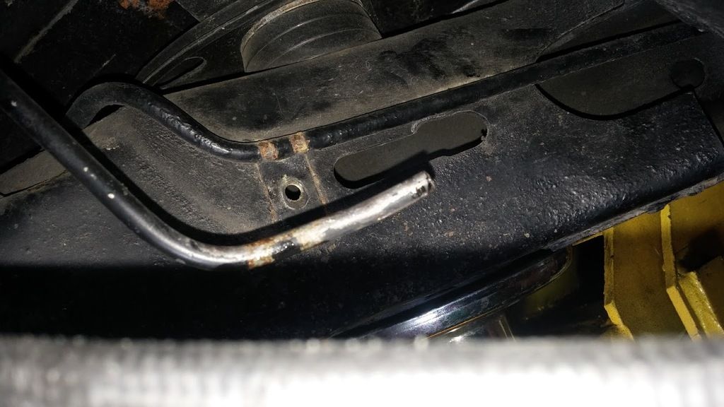

This let me pull the front half of the line away from the frame once I had all the clips loose. This extra room let me get my pipe cutter on the line near about the B pillar, or right behind the rear footwell.

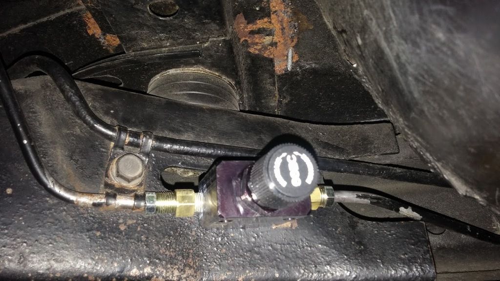

I slid a fitting on the line (yeah me for not forgetting it) then flared the end of the line. I had picked up some 3/8s to 1/8" flare adapters which went into each end of the prop valve then I marked the front half of the line and cut about 2.5" off the end of it. Once that half was flared, I installed it all again, tweaked the line a bit here and there, fixed a leak or three...and here' show it sits now.
It's tucked up behind the footwell so I think it'll be safe and I can reach it easily from outside the car, just kneel down, reach under and twist the knob. Once I'm certain it's all good I'll probably fab up a bracket to make sure the valve stays in place and maybe protect it a bit as well.

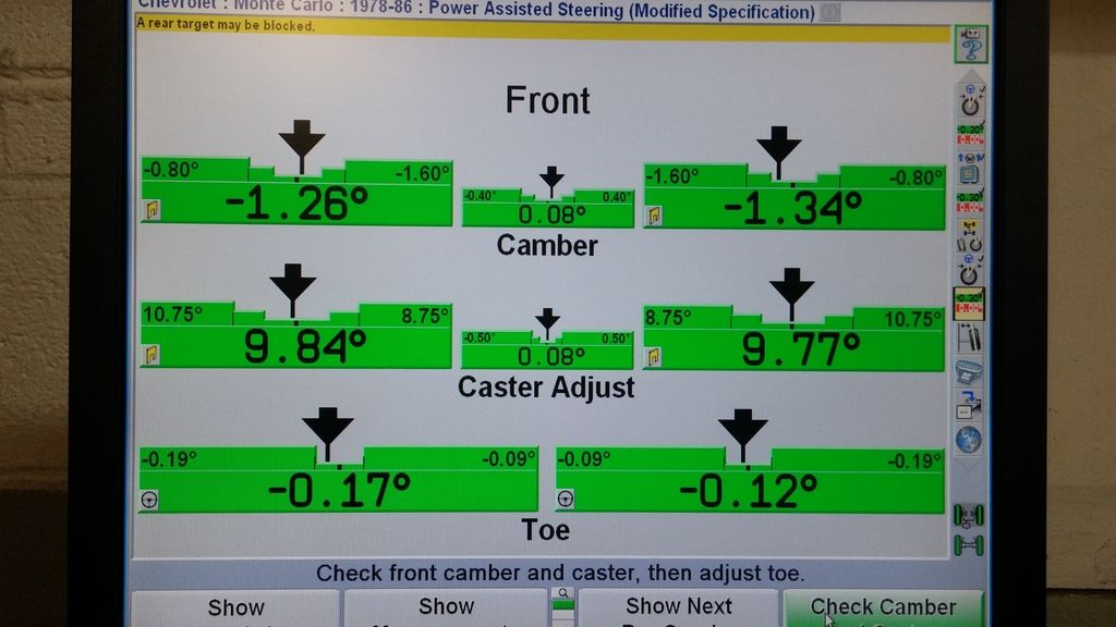

So, here is a pretty good illustration of how my Ron Sutton Optimized front suspension geometry works...and why this car turns so much better than a stock geometry G body.

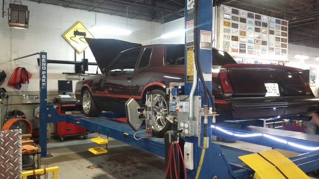

I recently lowered the front ride height 3/8" and the rear 7/8" and it had been at least 2 years since I've had Barney on an alignment rack. The jigs I built to do my own alignments at home...don't fit the new wheels...so I figured this was as good of a time as any to do it right and get some real accurate readings on things at the same time.

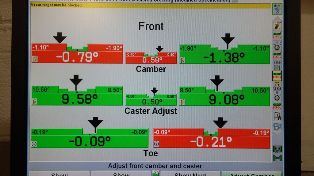

Here's what she looked like when I first rolled it up on rack.
Previously I had set the camber at -0.75 and caster at +9.75. Changing the ride height added camber, but not enough to the driver side for some reason. Caster on the right front was also off.

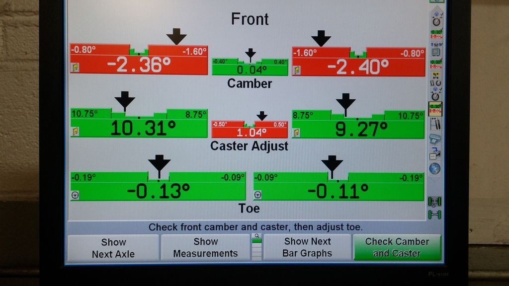

We decided to shoot for -1.20 Camber, +9.75 Caster at ride height and an 1/8" toe out (more on this later). We got it pretty close with two small adjustments.

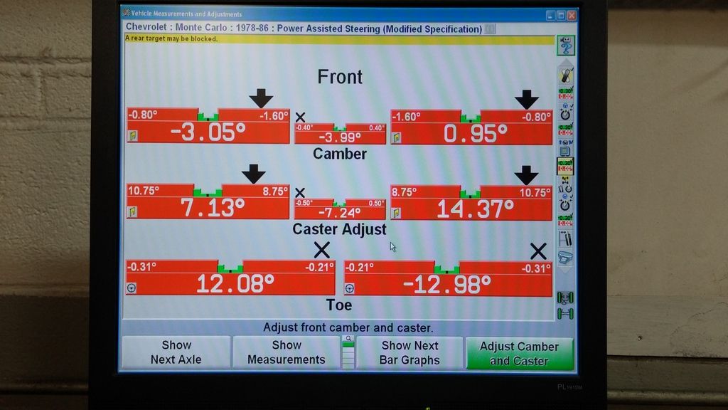

We then put a pull down jig on the rack and pulled the cross member down 1". This shows what the geometry is doing under braking, like on corner entry.
Cross member 1" down, wheels straight ahead.
Notice it gained right at 1 degree of camber under bump.
We then turned the wheels 20 degrees to the right.
Then left

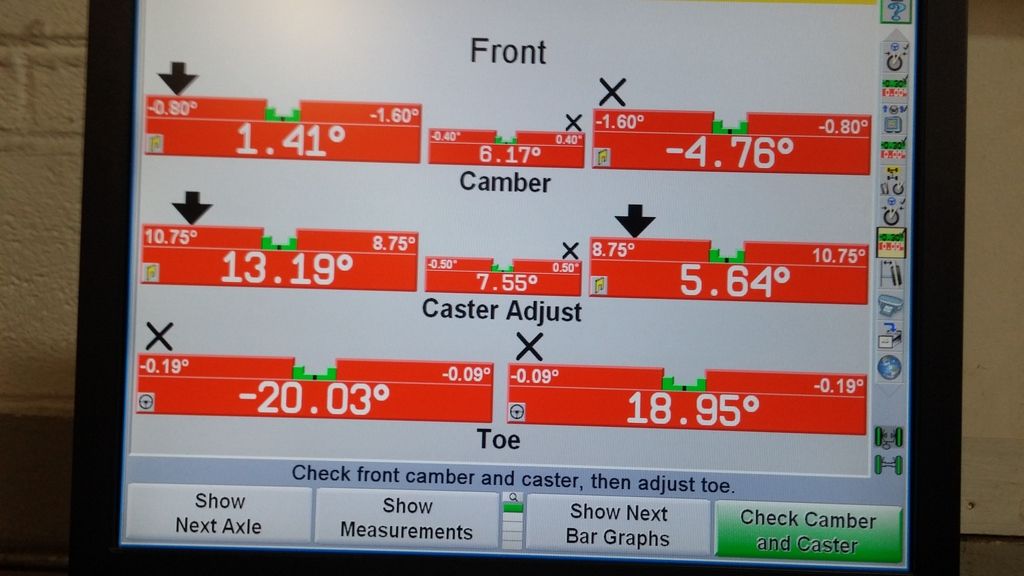

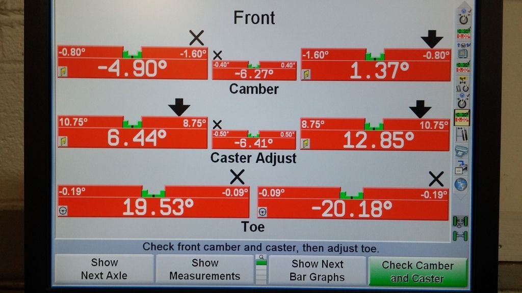

Check out the camber gain now! 1" dive and 20 degrees input puts the outside front at almost 5 degrees camber PLUS the caster puts the inside front at + 1.3ish...exactly what one wants to get both front tires digging.
Ron then explained to me clearer that he wanted 0.26 degrees toe out ON EACH TIRE...so we made some further toe adjustments.
Ride height, wheels straight ahead.
We figured out that about one half turn on the steering wheel is close to 13 degrees of steering input...which is about all I typically use on an autocross course. So we took one more reading, 13 degrees right at ride height.
Notice the toe is now 0.90 degrees and it was 0.56 with the steering wheel straight. This shows it is picking up almost a 1/4" of toe out with 13 degrees of steering input. It also shows 3 degrees negative camber on outside front and +1.00 camber on the inside front...at ride height.
