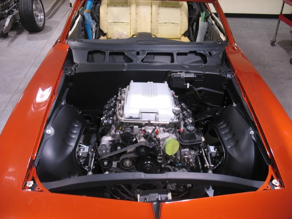

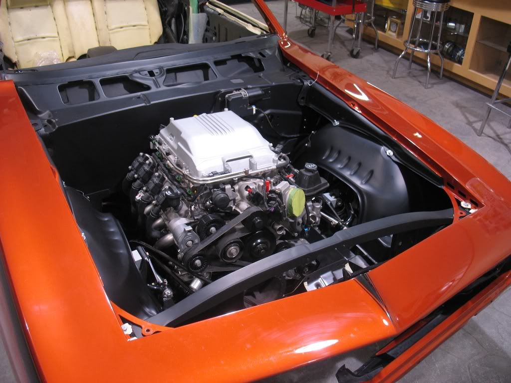

We fixed (repainted) the firewall, dash area, inner fenders, rad cradle, inside of fenders and front end, door jambs, and finished the windshield frame. If you notice in the previous pictures the paint shop that did this did not even paint the winshield frame. They were "going to do it later" so we did it. The door jambs were so chipped from lack of care we had to re spray them too.

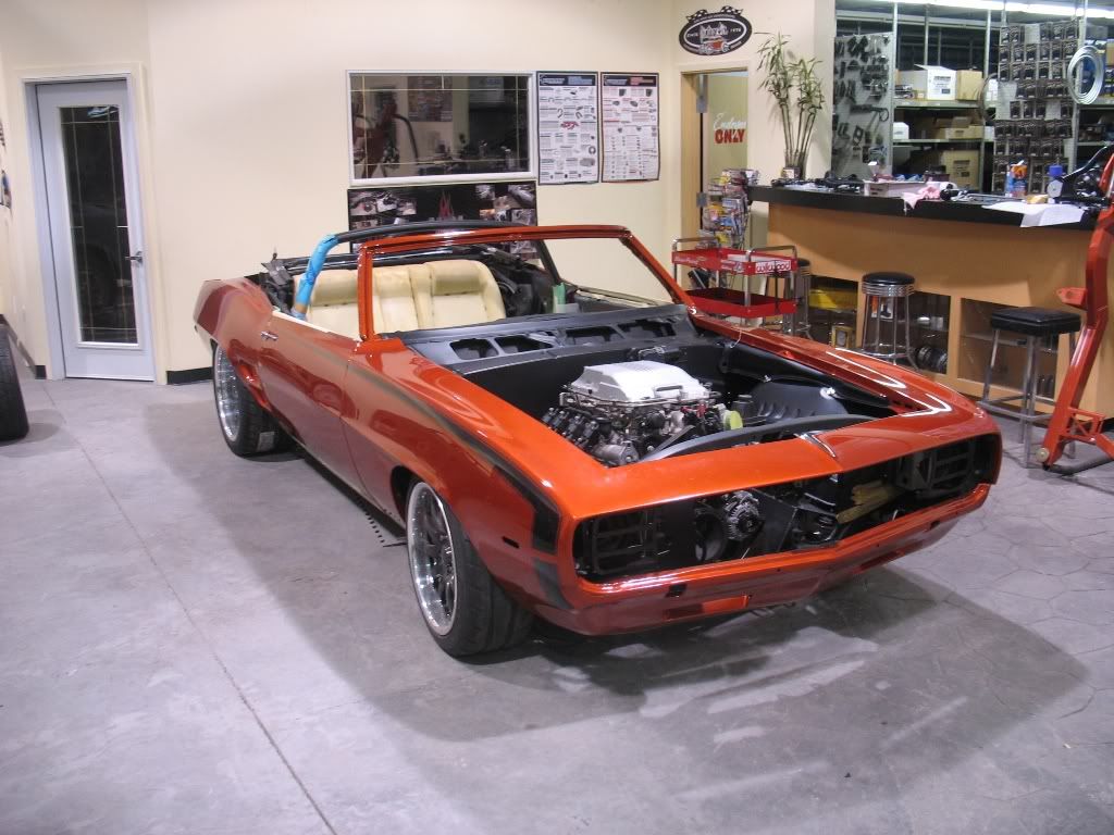

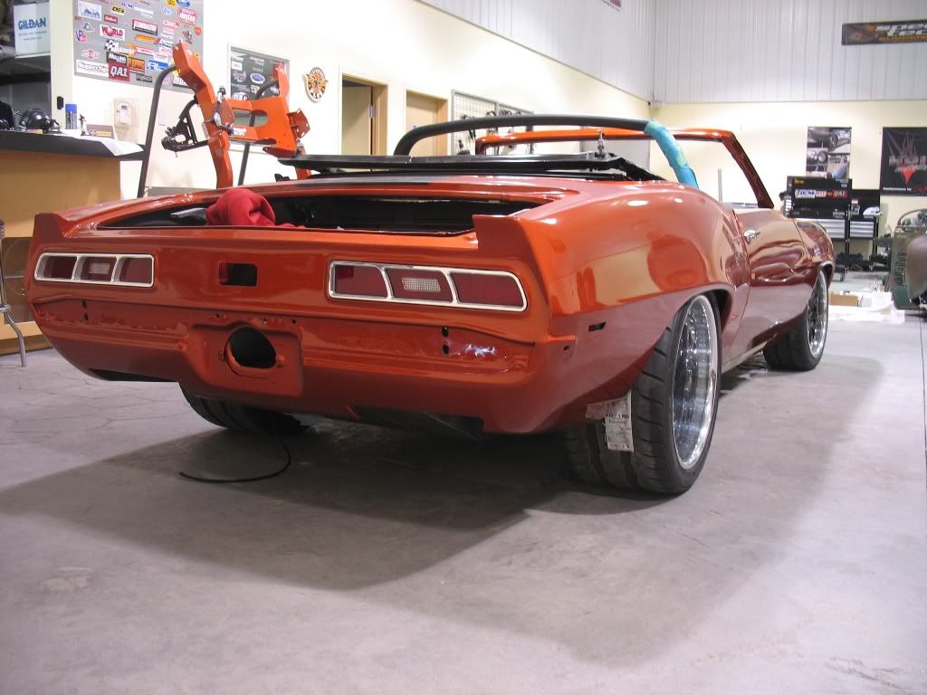

So we got the front clip back on and almost done aligning, just need to add the hood and trunk. Then reinstall all the plumbing, grille, and on to the interior.

If anyone picked it out in the last pictures, yes those are temporary grade 5 fasteners holding the fenders on. We are machining custom fasteners for all the fender bolt locations.
