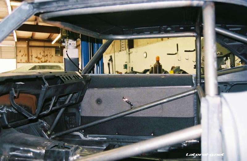

An idea that I like from 21st Century Street Machines is incorporate the roll cage as part of the structure so you cannot see it...since you are going for the sleeper look. IE. run the halo bar as close to the roof as you can. The bars that come down the windshield pilar, weld a filler plate from the bar to the pilar.
Scott if you are reading this post up a pic of Conrad's 69 with this done.
  #78

Originally Posted by Payton King
...since you are going for the sleeper look. IE. run the halo bar as close to the roof as you can. The bars that come down the windshield pilar, weld a filler plate from the bar to the pilar. Scott if you are reading this post up a pic of Conrad's 69 with this done.
Here you go, Payton:
My LS7 69 Camaro

Scott -
Thanks for the pic of this rollcage installation.
I ripped my old one out (an 8 point steel bar) and replacing it with a 10 point chrome moly cage and this is exactly the way I wanted to fit it, so thanks. If you have a couple of other shots, please tell me where and I will snag them for the chassis shop. Thanks again.
