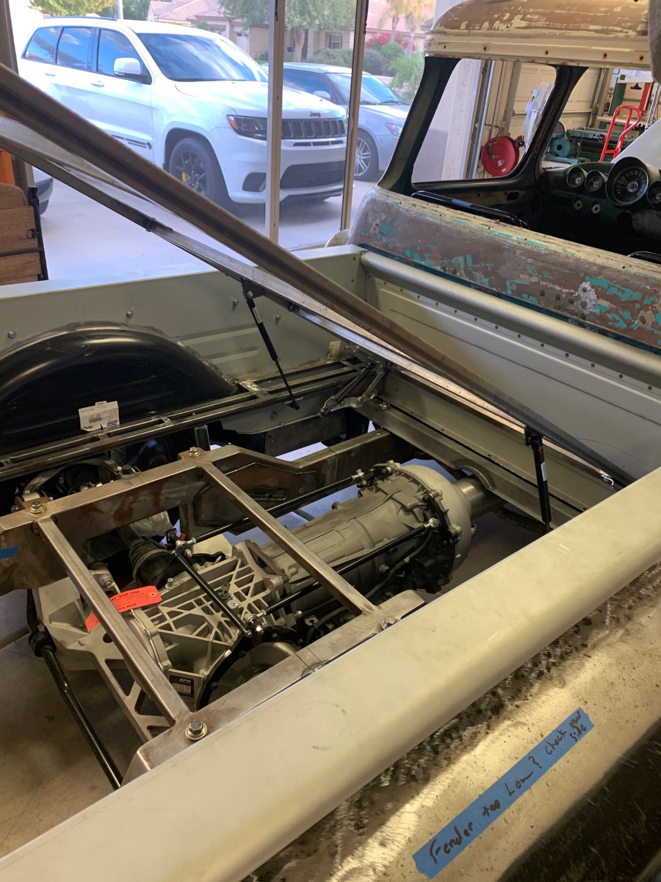

Bed floor dialed in and done. Ready for wood. Added 60lb gas struts to lift and keep from lifting all the way up. Quick disconnects make lifting all the way up easy. I kept the gas helpers on the hinge, they keep it straight up when I remove the long struts. I added in tunnel clearance on crossmember for the torque tube(drive shaft).

Really nice!! Who's chassis is that you're using?
