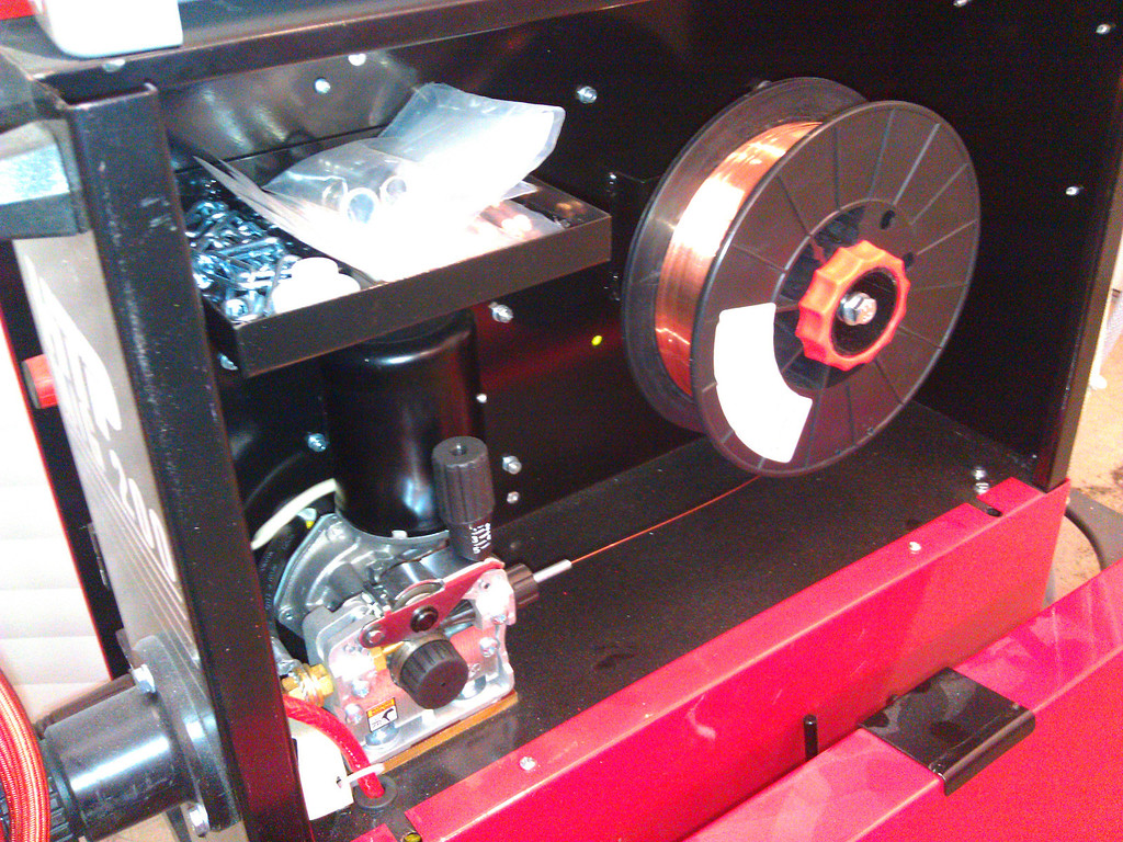

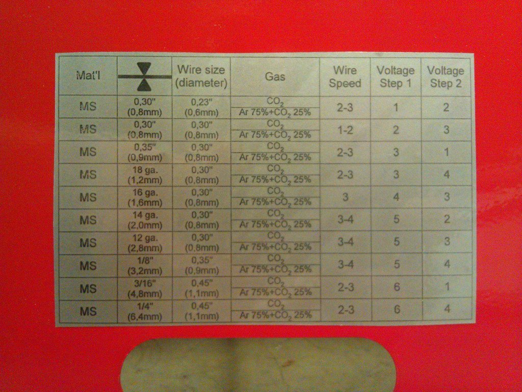

What sort of setup table does your HTP MIG200 have? I am used to a nice chart inside the wire compartment on a Miller 252. Would you be willing to post a picture of yours at all please?
Also, how do you like the heat setting adjustment being what appears to be a 2 switch analog arrangement?

The 2-switch set-up is not as simple as my Lincoln 135+............basically it is 6 main power settings of which each can be fine tuned 4 levels. Wire feed is the critical/finicky setting with the machine. I'm running .023" wire for most applications.

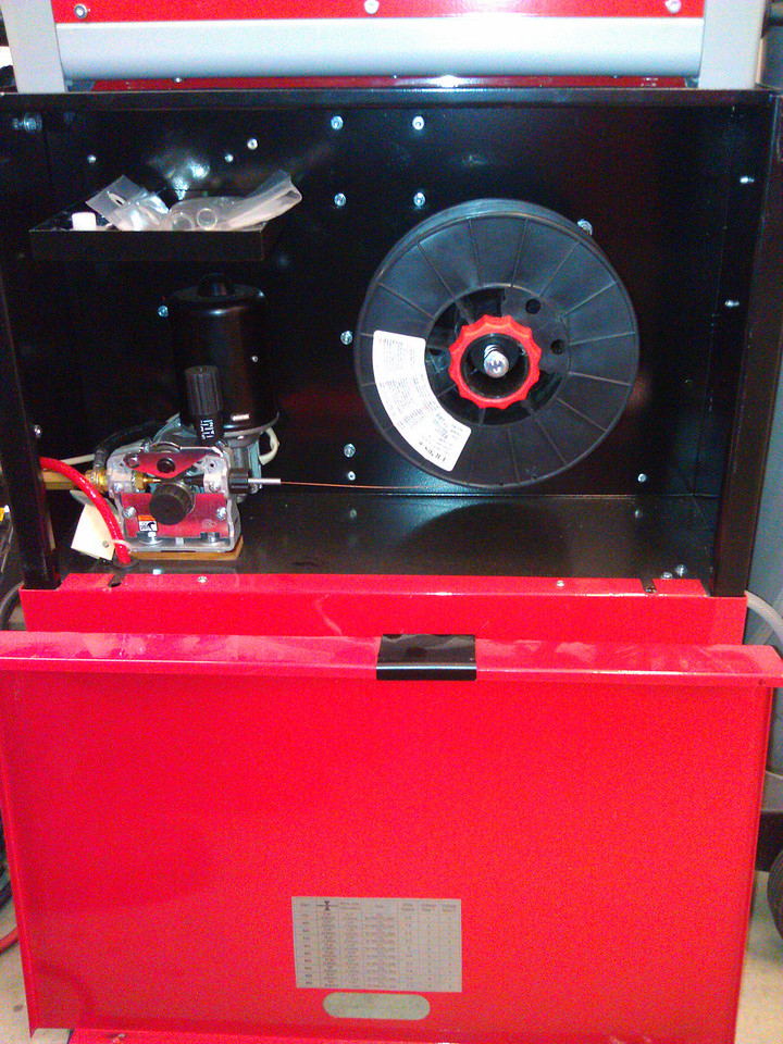

Thanks for posting the picture. Is that all they gave you is a piece of paper?

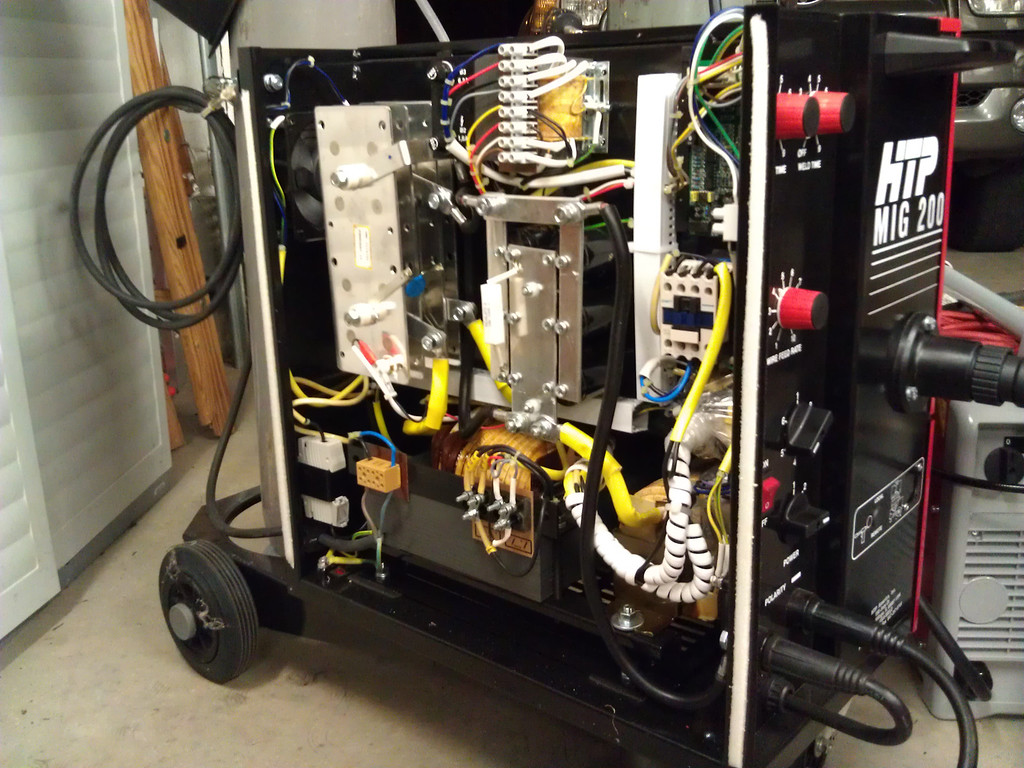

I appreciate you going through the trouble of posting that but perhaps I was unclear. I was wondering if the machine has a nice decal or chart inside of the door where you access the wire spool such as what I have seen on the Miller machines I have used. It seems like a trivial thing but you know how it is, paper get lost, tattered or dirty and in my experience is not fond of fire or melting metal
I found it difficult to find a picture of an HTP machine depicting the wire feed compartment in whole, lots of closeups of the gear drive and the transformer/electrical side but not what I wanted to see.

Yes it has a decal on the inside of the door which requires opening the door to read. I copied a page from the manual for reference convenience. Paper in the form of *.pdf's is harder to lose, tatter, or dirty.
