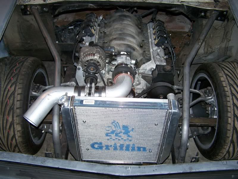

Well, it's been a long couple weeks and I haven't got much accomplished but here is where I am at. I mounted the I/C but I still need to make support brackets for the uprights. Each piece that gets placed in the compartment reminds me how cramped it's going to be.
Basic overview, BOV and cold pipe in place.
Running the hot side pipes are going to be interesting. I am planning on running them even with the downbars but just underneath which on the passenger side is no big deal, but I have a P/S pump to contend with on the drivers side.
This view shows how high I have the I/C mounted. The plan here is to split the incoming air in two. I am hoping to have a lower valence/air dam that will direct air under the I/C and onto the radiator. It's kind of hard to picture it without the front end mounted but imagine the very bottom of the current fiberglass even with the bottom of the frame heads. The air dam will extend another 4-5" below that and have it's own shrouding.
BTW: I have removed the coil packs for the time being until I can figure out exactly where the turbos are going to end up. I've experimented with the coils removed and the turbos mounted down low(where they're at in the pics) and up high with the coils in place and I like them better up high.

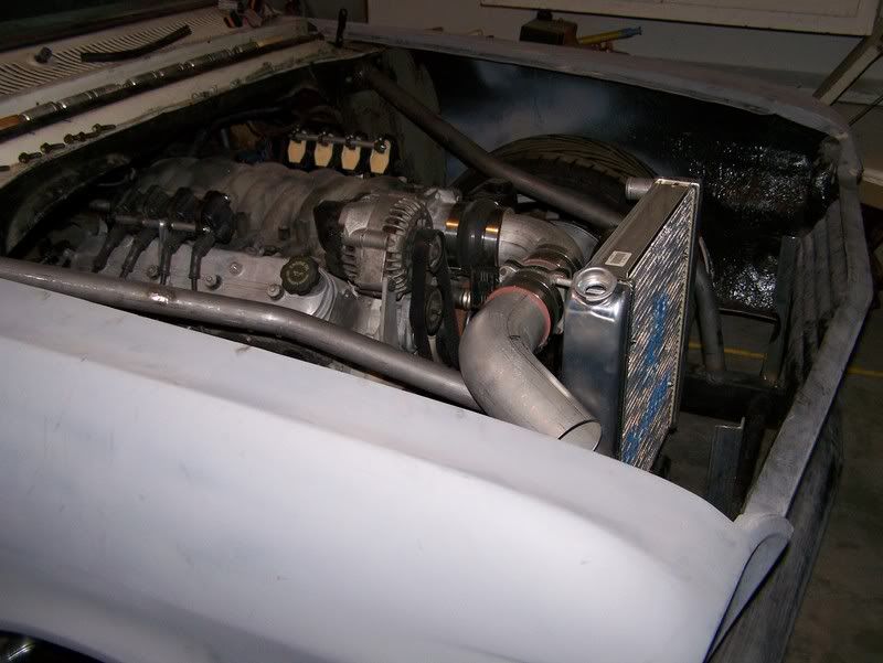

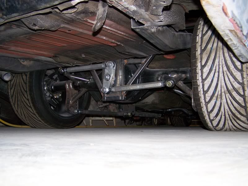

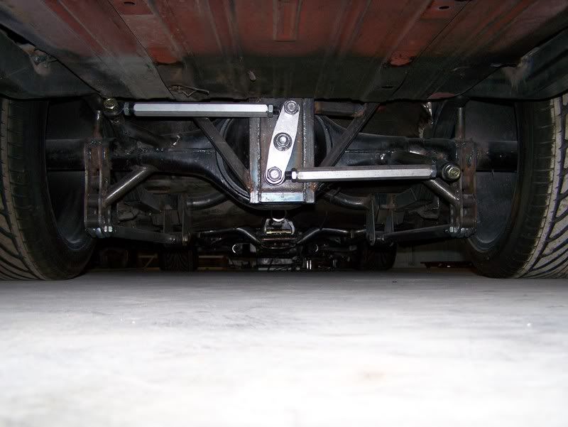

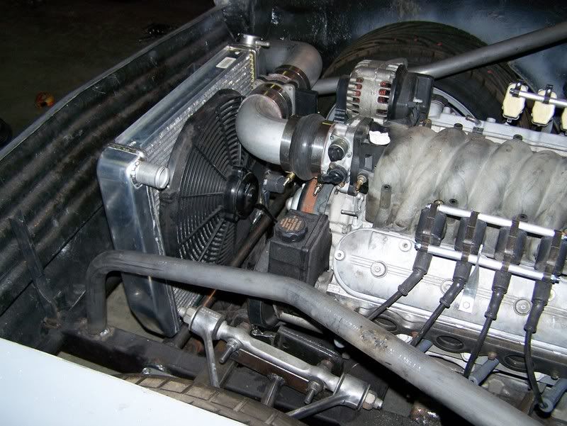

I've had some pretty major changes both with the car and some personal things lately so I've sold all the turbo components. The twin turbo set-up will live on through another Nova guy.
Anyway, I've had a little time to start moching up the radiator and intake as well as redo the watts link. I have been shopping around for a C6 Corvette factory take off airbox/bellows/maf etc but I had some leftover 3.5" aluminum tubing so I'm just going to use it instead.
The 9" bars I was using on the watts link didn't allow enough suspension dropout to remove both wheels at the same time so I picked up some 12" bars and remounted it to the rearend.
HP tuners, headers, exhaust, fuel cell, fuel lines, radiator hoses, a few small items and the engine will be ready to run.
