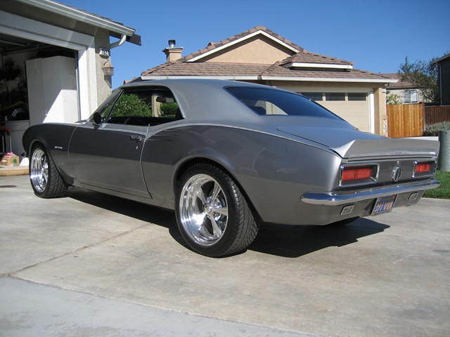

In the front, I have a 5" BS with 8" rim, in the back I have 5 3/4" with 9 1/2" rim. With the mini tub and larger rim though, I can't help you.

I like the wheels on your car. I might not tub mine. What brand are they? Where did you buy them? Thank you for your time.

They are Billet Specialties. I used 245/40/18 in front and 265/40/18 in back.
