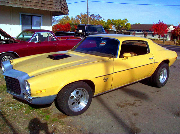

I've finally got enough parts together at once to start the reassembly on my 73 Camaro.
Before I got her she was an 80k mile original numbers matching car, but she'd been hit up front so the front group had been replaced with some secondhand parts. I got her from my best friend, and while it was his the old 350 finally gave up and seized a bearing, so we swapped in a 283 that his dad had in his shop.
That motor was bored .060 over, had 12.3:1 compression, the biggest heads you could fit on the little mouse, Comp 280h cam, port matched original 60 something GM aluminum intake and all sorts of goodies, so it wasn't really a slouch.
After he found out his wife was pregnant it warranted sale, so I ponied up the cash since I didn't want to see her go far. About a month after bringing her home the old tired TH350 decided to go, a while after that she went into the garage for a tear down. I removed everything from the firewall forward and vowed to start fresh.
