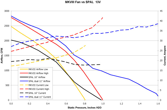

I mention all of this only because I happen to have the attached graph. This is a graph supplied by SPAL illustrating the Ford unit as tested on SPAL's equipment. If this is correct, simply replacing the fan will not solve the problem as the cfm rating of the Ford unit is actually under the dual 11 (especially under static conditions)
I'm not bashing the Ford fan. It is huge and pulls a lot of air. However, I'd hate to see you drop a few hundred bucks only to find it was something else.

I disagree. I've had both, and the dual Spal can't keep up with the Mark VIII fan. I'm speaking of the later model Mark VIII (97-later I believe), not the earlier one. I know their drawing isn't accurate as the late-model Mark VIII flows over 4000 cfm. Well, either that or they're misleading you by comparing to the older Mark VIII.
I had the dual Spal exactly set up as you've shown and my car would still hit 210 at idle with the a/c on a 100+ degree day. With no changes but the fan swap it wouldn't break 190. That tells me the Mark VIII definitely has more airflow.
