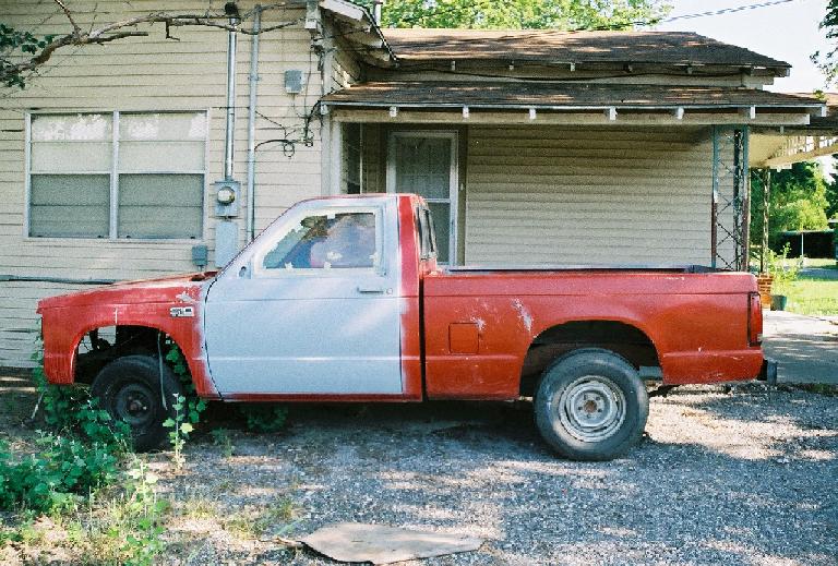

Ok. I picked this thing up for 275. and am currently in the process of parting out everything that came with it that i dont need. to raise funds for what it doesn't have and i do need. it is an 89 s-10. im looking for help and guidance from you guys. MAINLY with the suspension but also anywhere else anyone wants to chime in at. here is what i've got planned so far. (there is no interior or drive train)
Interior:
Fiberglass dash, console, and door panels
power windows and locks
carpet
GM electronics
Auto Meter Guages
Sport Seats
Cage?
Exterior:
Needs replaced:
front fenders
hood
passenger door
possibly bed
all glass
Wants:
cowl hood
roll pan
smoothed tail gate
Paint:
im thinking a dark metallic gray over silver. two tone
drivetrain
6.0 liter LS1
t56
moser 12 bolt
suspension/chassis
tubular a-arms and coil overs up front
3 link? outback. or something that would improve handling
fuel cell moved behind axle
wheels/tires:
open to suggestions.

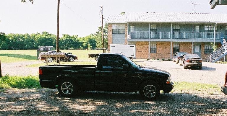

i only have one picture right now. i'll try and snap some more tomorrow (wed) the first pic is of the 89 the other is of my 200
