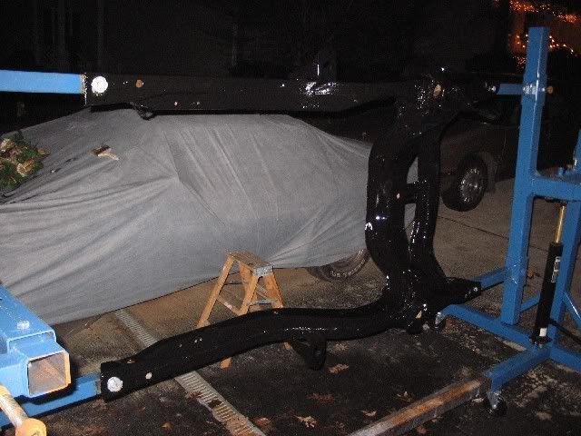

Got a lot done tonight! My wife and I painted the first coat of POR-15 on the front subframe! Tomorrow night we'll do the second coat and then it'll be ready to install the suspension this weekend, and then back on it's wheels when I get the spindles back from being modified for the LS1 brakes by Ed Miller!

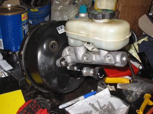

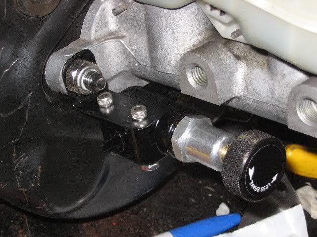

I also fabbed up a bracket and mounted the Wilwood adjustable prop. valve. I was going to bend the brake lines tonight, but they sold me the wrong fittings at the store, so I gotta go back tomorrow and get the right ones.

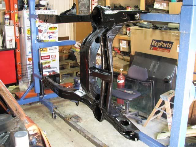

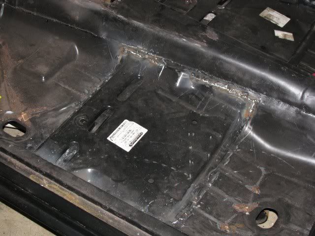

Big day today! I had the day off of work, so my brothers came over and we knocked out a lot on the car. I finally got my welder back from the shop and got the seat support all welded in. We also got the final coat of POR-15 on and a topcoat of Rustoleum semigloss black and then installed it on the car with the new Prothane bushings. Also had to run around town trying to find the right fittings for the LS1 brake booster before I realized I had a spare ABS module in the attic and could get the fittings off of it. I also started working on the subframe connectors and rear frame, I hope to have it all tacked in and mocked up this weekend. I told myself I'd have it rolling by the first of the year, and that could be a real possibility!

Progress is good! Looks like you could slow the wre speed down a little and possibly turn the heat up a setting, just try to keep most of the heat on the steel not the sheet metal...I know this is a bitch! But play with it as this is structural stuff you are doing here!

I'll try that, thanks! I plan on just tacking most of the structural stuff and then having a local welder I know come over and put a couple passes on it to make sure it is on there strong. I don't trust my welding enough for structural things!

I agree with this, also, make sure your metal doesnt have any paint / dirt / etc... on it before welding... as it is now it looks painted which will have to be stripped off before a pro comes in and welds it up
I bought some metal and played for a day or so with each setting on my welder and made notes of what each speed / heat did and how it affected the weld
Have fun with it, i love learning new things on mine (it is my 1st build also)

Thanks guys! I did strip the paint on it with the wire wheel just along the seam where I am welding. I learned my lesson the first day with all the popping and spitting!
