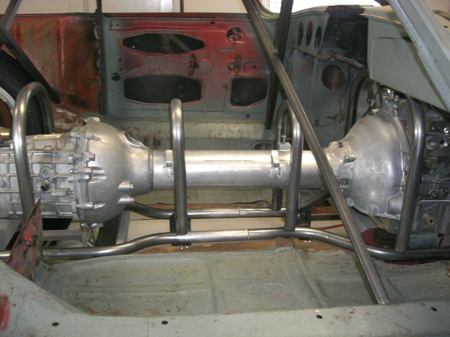

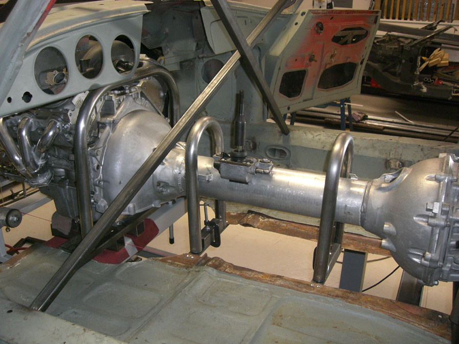

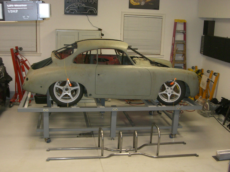

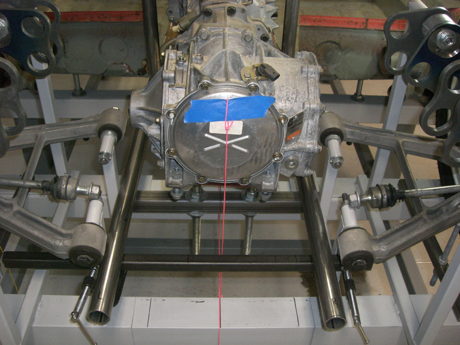

Took some vacation time so I could work on the car. Backbone and lower A-arm pickups almost done. Should get the a-arm tabs from the water jet guy tomorrow - that is if the nascar guys will stop it with the last minute orders for Daytona....

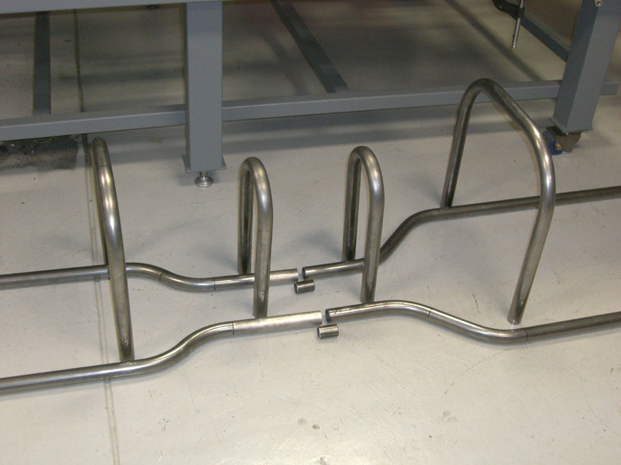

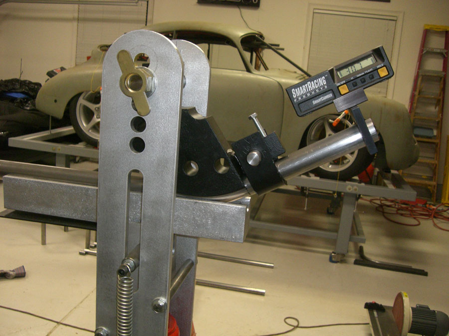

Rodger at www.ironworksspeedandkustom.com stepped in at the last minute and bent some hoops for me - benders in my area had a 4 - 6 week lead time and I waited too late. Thanks Rodger !!! (and shipping in a Budnik box was perfect !)
I've never done this before - and it took a couple (now scrap) tubes to get the hang of bending offsets. I could bend 2 in a row, but when I tried to do the entire piece with 4 bends on this style bender - both sets would be on different planes and dog legged something awful. So I split it in half and will stub in an insert.
Going to complete the backbone tomorrow and finish clearing the underbody for the perimeter tubes that connect to the backbone.
Jim

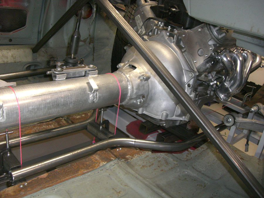

Back Bone in. Time to get the tube notcher setup. No parts from the waterjet guys today .... bummer.

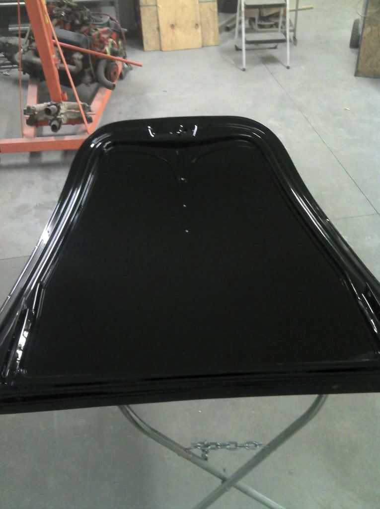

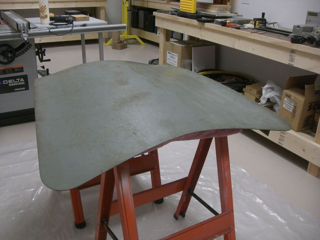

Going to make a carbon fiber Hood and GT Porsche Seats from my steel originals.

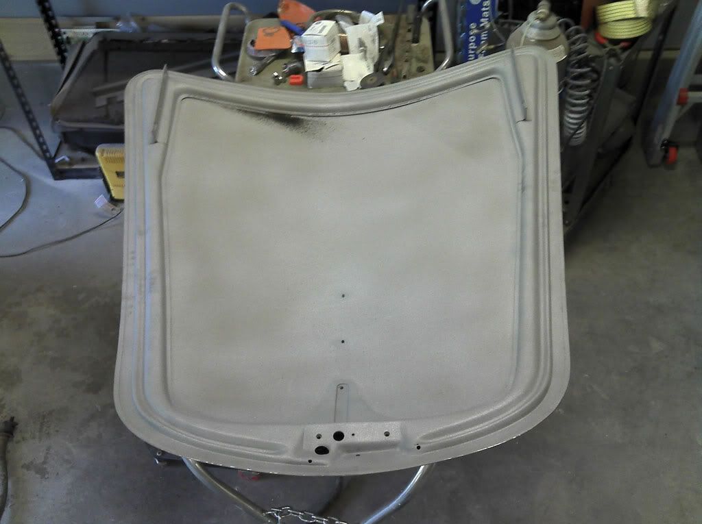

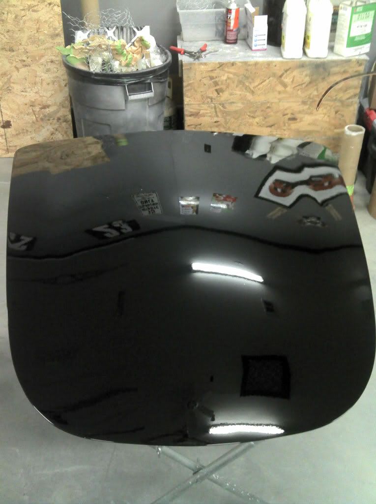

Needed to media-blast, seal, fill, prime and topcoat the parts so I could pull a mold off them. A lot of work… really good to have friends that do this kinda work daily !

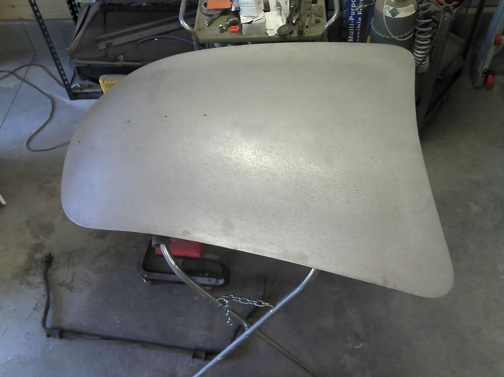

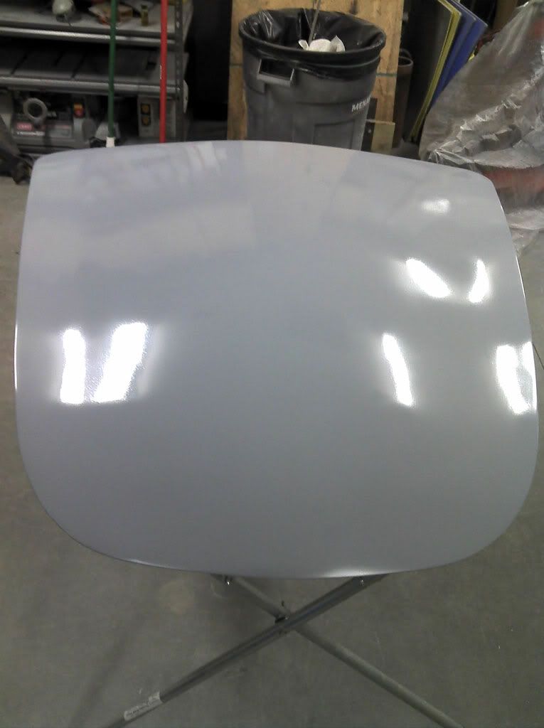

Hood

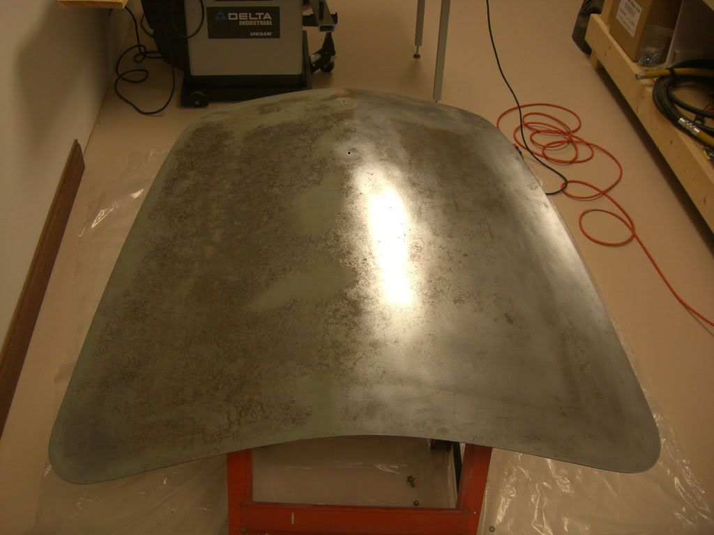

20 year old primer was chem-stripped.
Found sub-primer rusting
So I had it media-blasted
Then body work and sealer.
Then top coat in black
Jim
