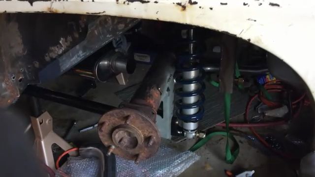

Front suspension has the Guldstrand mod with hybrid 13” c4/c5 brakes and Z06 red calipers and hydroboost brake assist from Hydrotech. It also has hidden spring adjusters installed and poly urethane bushings that will be swapped for Delrin or equal after I start driving it. Steering box will be upgraded but I haven’t decided on what box to go with. Eventually I want to get the adjustable a-arms from SC&C.
For the rear it has 3” drop leaf springs and offset shackles from SpeedTech. 12 bolt out of a Chevelle with 4:10 gears and a posi. Later it will be converted to a coilovers and a torque arm setup. I need the back seat for the kids so that leaves out any 3-link. Brakes are from a LS1 Camaro with Z06 calipers.

Here are some pictures. First here are some hubs that I have. The left one is a two piece disk brake hub and the one on the right is a drum hub.
This is the bracket I made for the disk brake conversion. you can also see the s10 bump stop.
C4 13" rotor and C5 caliper.
With wheel and tire.
