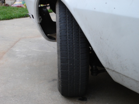

ive done finger tight and ive also torqued the berrings to 12ft/lbs like it says in the manuals. Ive got poly control arm bushing and one of them seems to be warn, could the little bit of play in that rear upper control arm bushing cause the wheel to lean in or out too much while cornering and put to much load on that outer bearing causing it to over heat? this is the only thing that i can think of. I had this kit on for around 2 years before this problem ever started and other than this i really liked the kit, it was very easy to instal and work on

I dont think its a bent spendle because they were changed when i did the disc brake converson and it hasnt taken any hard hits or anything like that to bend one. i set up a dial indicator on everything thinking that maybe i warped a hub and that was causing some sort of stress on them but everything came out with less than 2 thousands runout so i figured that was pretty good. Does anyone think that that one messed up control arm bushing on the rear of the upper control arm would make a big enough difference in camber to cause excess pressure on the outer wheel bearing?
