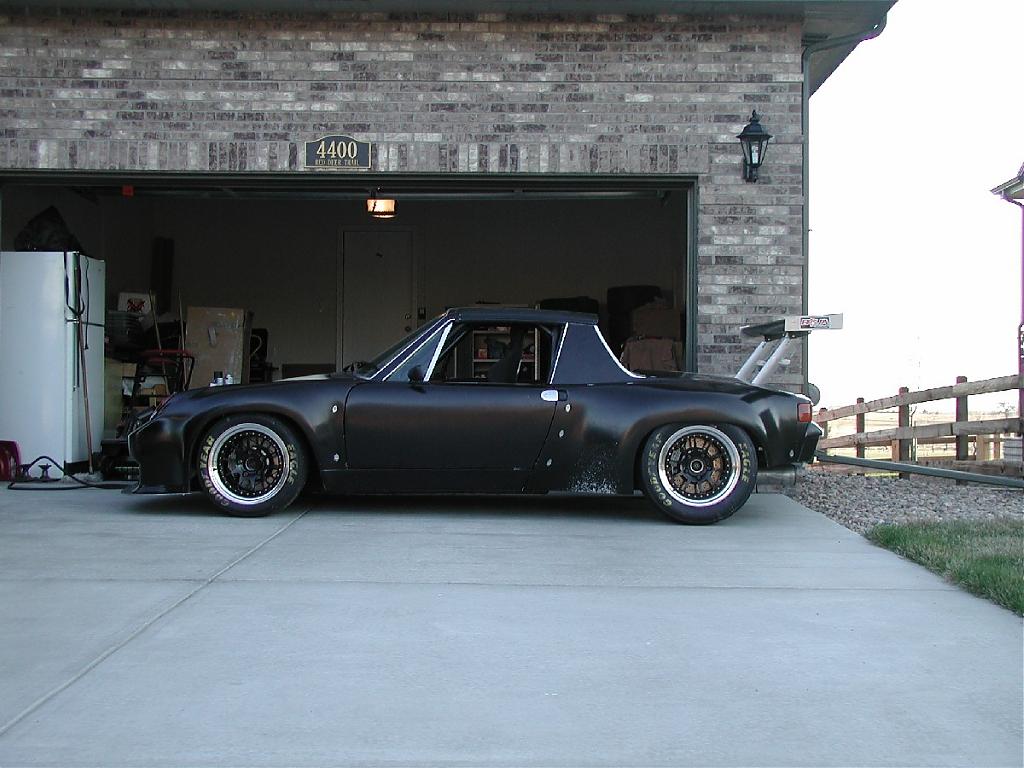

As for the 914, it is very little Porsche these days. The center "chunk" of a 914 was retained to hold the windshields, doors and roof in place. It is full tube chassis front to rear, 935 RSR front struts, custom 5-link rear IRS, 525HP/438TQ 11:1 353ci de-stroked 400 (steel 327 crank) with a Porsche 930 turbo transaxle running inverted (upside-down). Wheels are 16x10/16x11 Kodiaks with anodized black centers with GY 23.5x10.5x16 front/25.5x12x16 rear slicks. Stock dash (with Autometer gauges), doors, decklids and fully operation flip-up headlights and all street-legal (minus just being loud it meets vehicle code).

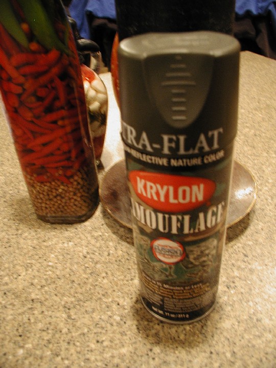

OK, hit Advanced Auto and semi-flat black was on sale!! Bought every can and checked out all the paints. Krylon really only had one green I would want, and it is camouflage green that us ultra-flat. The camera wasn't doing the best job in the house tonight but here is what I am going to be using (looks a bit like #1 and #4 had a kid - the cap is just slightly darker than #1 but I bet it turns out darker in reality, more like the green with the striped images).
They have an ultra-flat beige too that I could use to stripe it like stripe top right smile.gif
And you can see on the rear fender why I rattle can the car v. pay real $$ to have it painted nicely....

Cool car! That looks like a blast! What does it weigh?
