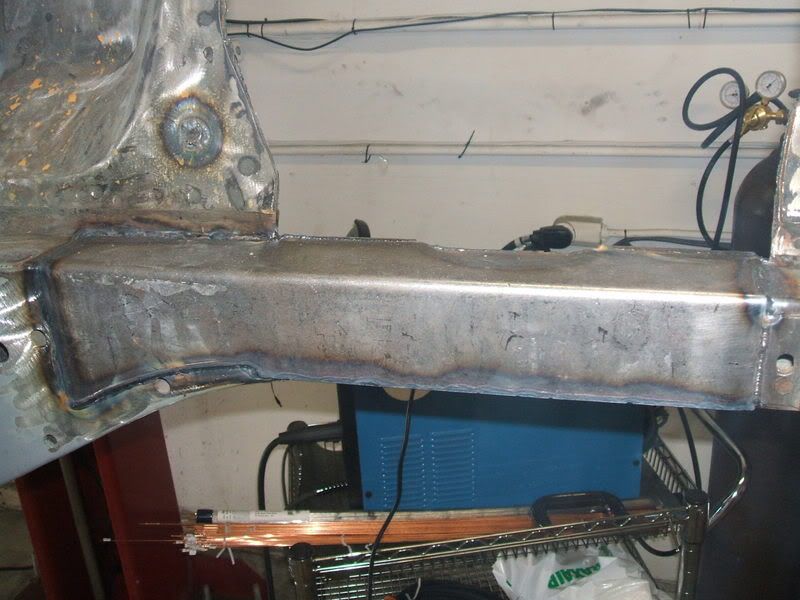

Well have you priced the other stuff ? I did when I did my car and its just cheaper to do the m2 setup if you want good brakes coil overs and the nice steering of a rack.
You will actualy spend about 1500 less on a m2 front ifs with coilovers and tubular arms then you will on a full bolt in system and rack and pinion conversion and big brakes to fit the stock setup.
as for what your saying about the frame rails well they arent carrying any more weight then they did with the shock towers the towers are part of the inner fender and frame rail and when you cut them out and weld in a piece to replace them the frame rail is just as suported by that piece as it used to be by the shock tower.
i used the heidts system not the martz that removes the inner fender completly

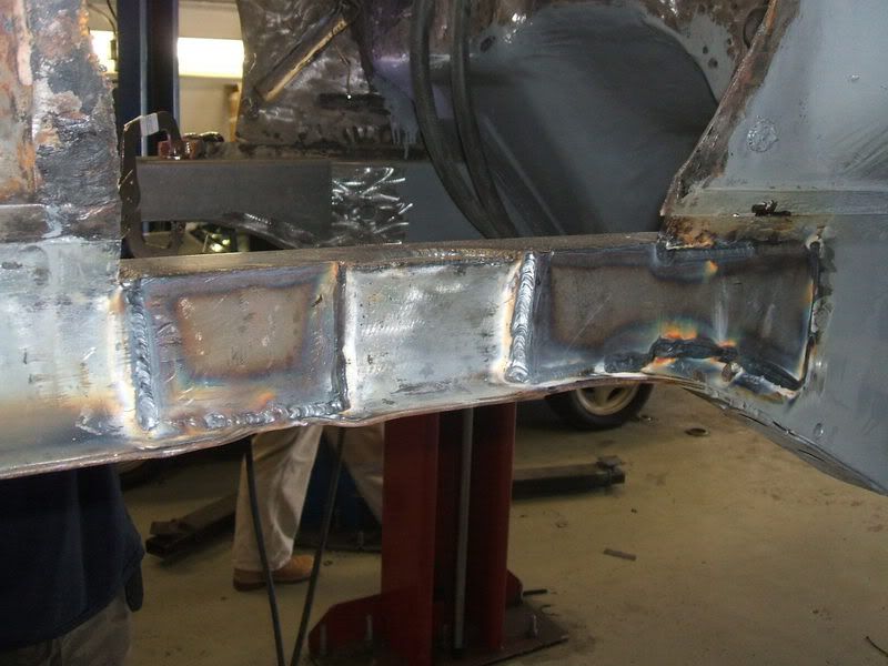

it also includes 8th inch thick steel reinforcment plating to stiffing up the front frame rails.
the marts system requires you tie back into the firewall because they put in a whole new front subframe and there is no more inner fender welded to the frame to tie it into the front of the car and fire wall.
but the heidts doesnt do that it leaves the inner fenders in place and only removes the shock towers.
if you look here you can see how beefy the cross member is and how you just cut the towers out not the whole suport of the inner fender.. once you weld in the replacment panel that is just as suporting as the shock tower was but you now have a real cross member in there to tie the two halfs together
here you can see the 8th inch plate that comes with the kit to reinforce and spread the load ont he stock frame rail
