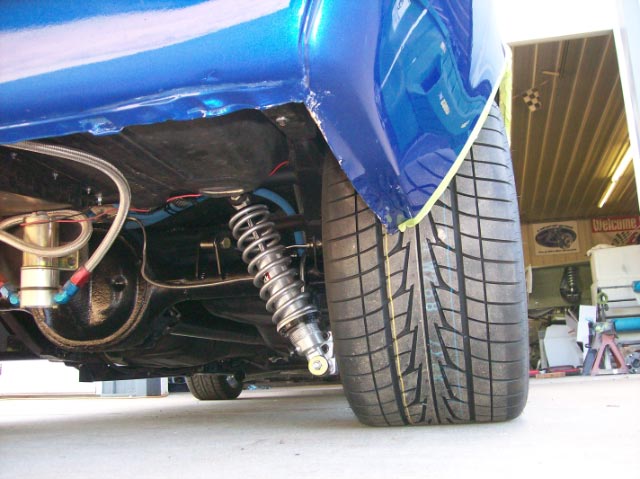

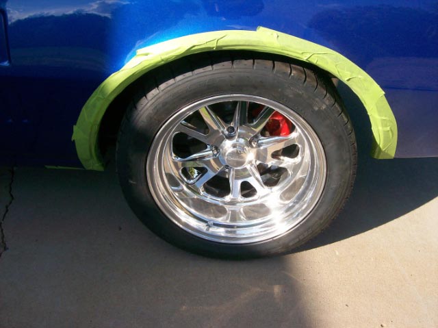

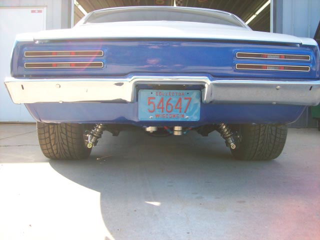

Default The Mini Tub Shes A DONE!
Kurt sent me these last pictures and said the car is all done except the exhaust. I am going to have take it to a muffler shop to have the tail pipes custom bent to work with the 4 link set up. Kurt said he thinks the tires are pretty close to dead center in the wells and they look pretty good to me in the pictures. When I get it home and cleaned up I will post some more pictures. Looks like some late nights in the shop to finish her up and get on the street again. I can't wait
