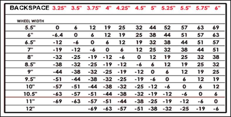

What is the backspacing in inches, 35 mm and 45 mm?
Thanks
Lenie

To determine your backspace from what appears to be offset (35mm or 45mm) - you'll need to supply your wheel width...

35mm (8 1/2") 45mm (9 1/2"). Thanks
Lenie

The chart that I have shows.
8 1/2" w/ 35mm offset = 6.12" BS
9 1/2" w/ 45mm offset = 7.02" BS
