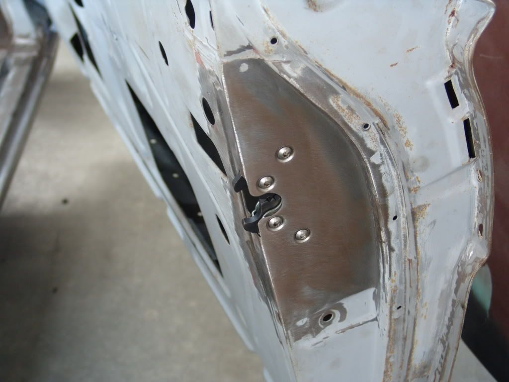

Not a whole lot to show, but the steering is in as well as the master cylinder/booster is installed.
new set of latches.......
