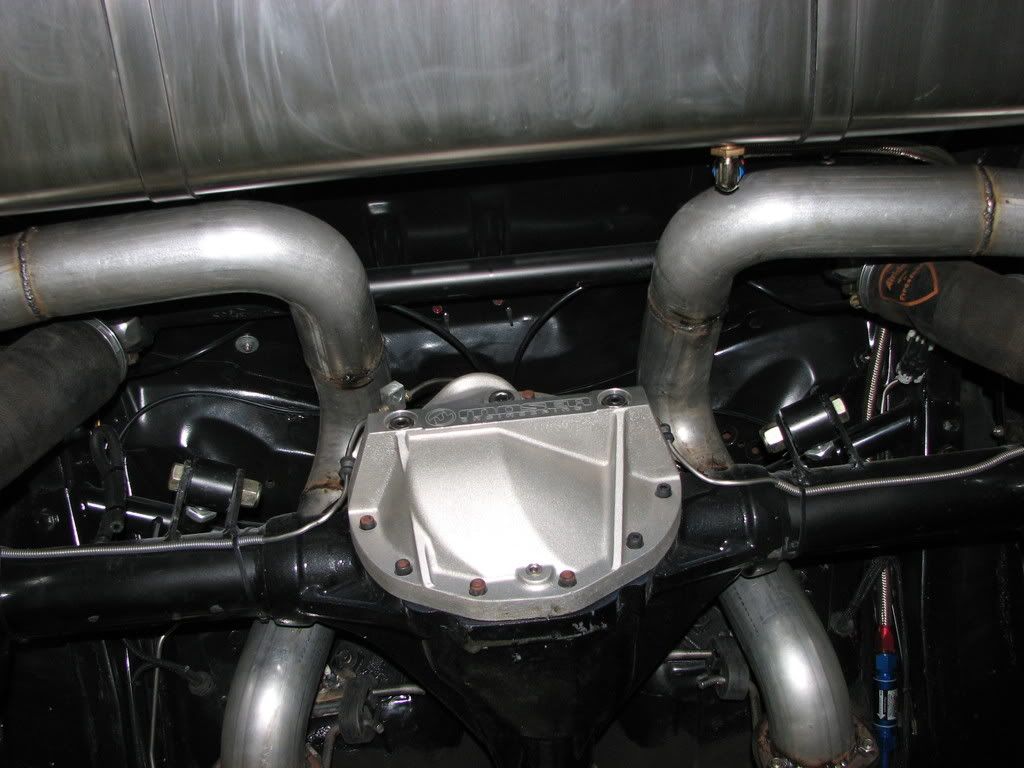

The exhaust on Velocity is really simple (ok, we cheated and used an aftermarket tank). But it simply goes under the rear end:

I don't understand the reluctance to run exhaust under the rear? We have done a couple of cars this way and both work just like any other exhaust. You can't see it from the rear, and it doesn't hit the ground, so where's the problem? Just cause it's always gone over the rear does not necessarily mean it always has to go there.

heres vinnys car, pipes clear bags by 1 inch, hes got 3-4k miles on the car with no issues, its full 3 inch pipe, 2 dimples are made for the casting gusetts on the 12 bolt.and vinny drives his car as hard as anyone

Now that looks good. Thanks for posting.
