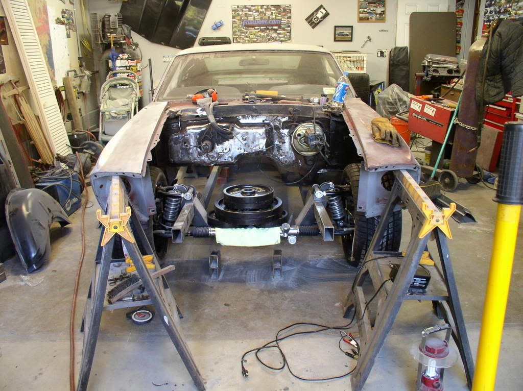

Frame under car crossmember will be at 5 to 6 inches off the ground
removed the old wiring as well
no rust in these floors

With the pans and the clip cut off, did you brace the car anywhere?

i am building a full chassis for the car as it was hit in the nose and the rear so i cant take any mm from the body ill square up the body once the frame is made

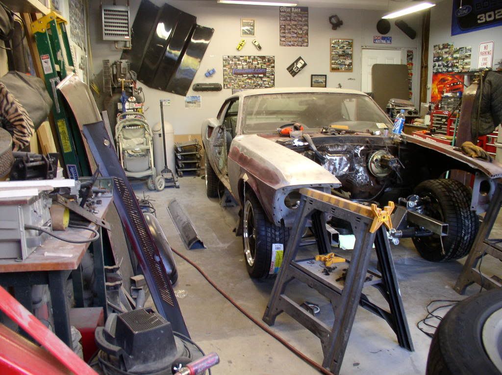

Front tires came in and had them mounted 275 40 17`s on the front ,finished up drivers side lower qtr panel patch repair ,mounted wheels to front end and slid under car to see what the turning radius of the tires would be ,mounted the front fenders to see if i have good tire track and clearances with the late model wheels so far all looks good ,lots more metal work to go ,ordered 2x3 tubing for the rest of the chassis, should start that this weekend..working out my rear track so i can narrow my rear ..Sorry no pics today ill get some up tomorrow..

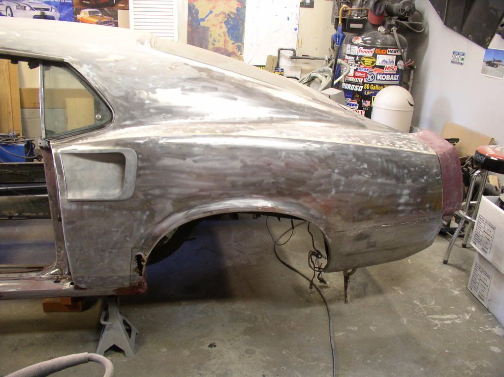

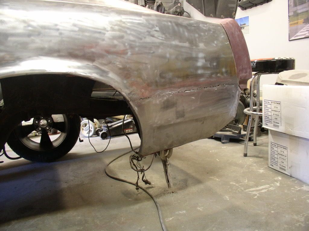

here are some pics of the drivers qtr repair and the front end with tires amd fenders installed still need to repair the front of the lower qtr but they do not make that piece so ill fab it up myself..
